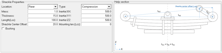

Shackle Properties
The following section explains the options used in Shackle Properties.
Figure 1. Shackle Properties Options
- Location
- Defines the shackle location; either Rear or Front.
- Type
- Defines the type of the shackle; either Compression or Tension.
- Mass
- Defines the mass of the shackle.
- Thickness
- Defines the thickness of the shackle.
- Length (Lss)
- Defines the shackle length.

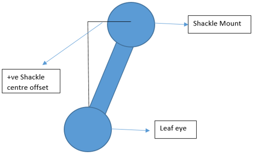

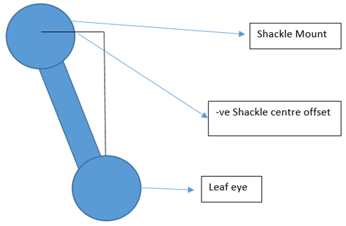

- Shackle center offset
- Defines the offset distance between shackle center and eye hook center in property file units.
Figure 2. Shackle Orientation for +ve Offset
Figure 3. Shackle Orientation for -ve Offset
- Inertia Ixx
- Defines the second moment of inertia about X direction of the shackle.
- Inertia Iyy
- Defines the second moment of inertia about Y direction of the shackle.
- Inertia Izz
- Defines the second moment of inertia about Z direction of the shackle.
- Mounting Length (LCC)
- Defines the distance between the shackle center and the far eye center.

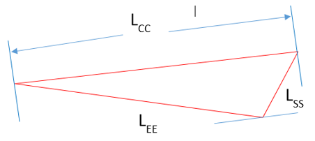

Figure 5. Shackle Geometry Triangle
LCC = eye to shackle length.
LEE = eye to eye distance of master leaf.
