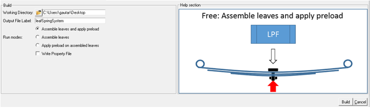

The options in the Build section are explained below:
- Working Directory
- Used to define a path which contains all of the files that are created
during the process of generating a leaf spring model.For example, if the output file label is "sysLeafSpring" and it has four leaves and the preload is applied, the following files are generated in the working directory:
- SysLeafSpring.mdl (required output file)
- sysLeafSpring.temp.abf
- sysLeafSpring.temp.h3d
- sysLeafSpring.temp.mrf
- sysLeafSpring.temp.plt
- sysLeafSpring.temp.xml
- leaf.log
- savedsysLeafSpring.temp.xml
- 4 .csv files that contain the shape data of each leaf before preload is applied.
- 4 .csv files that contain the shape data of each leaf after preload is applied.
- Output File Label
- Defines the name of the output file.
- Run Modes
- Choose any of the three options for the Run mode.

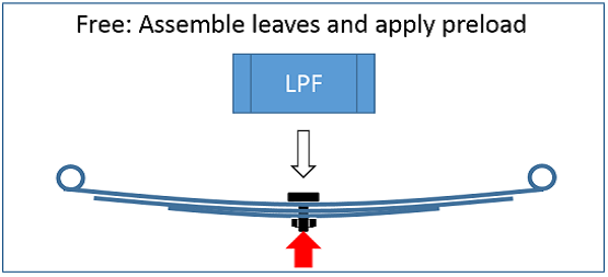

- Assemble leaves and apply preload Used to
generate preloaded system definition in one go without user
intervention. It generates a leaf spring system definitions as a
result, which can be imported into the model.

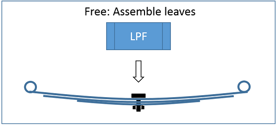

Figure 2. - Assemble Leaves Used to check the initial
model (before pre-loading) and modify some numerical values, but
strictly no addition of any new entities.

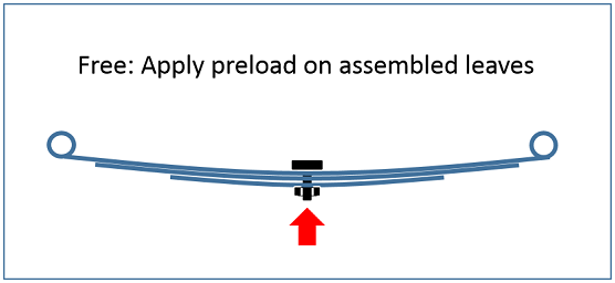

Figure 3. - Apply Preload on Assembled Leaves Runs a
modified .mdl model in batch mode and generates
a leaf spring system definition. Mode 3 is applicable only after
running the script in Mode 2. Mode 2 and 3 have to be used in
succession, else there may be errors.
- Write Property File
- Activate to generate the assembled model as a Property File format (.lpf).
