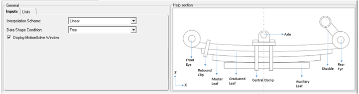

General
The General option in the tree browser provides basic details and displays the entire model in the Help section. It is necessary for all the property files.
Figure 1. General Panel Section

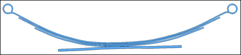

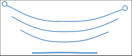

Figure 2. Spring in Free Position - Pre-Assembly: In Pre-assembly, you have
individual leaf profiles for each leaf in its free shape. These
individual leaf profiles can be bolted together first, followed by
applying a certain design load in a sequential simulation. The
following image shows that all the leaves are separated and should
be bolted together. Hence, if you have a free shape of each leaf,
you can use this option and enter the data accordingly.
Figure 3. Spring in Pre-assembly Position

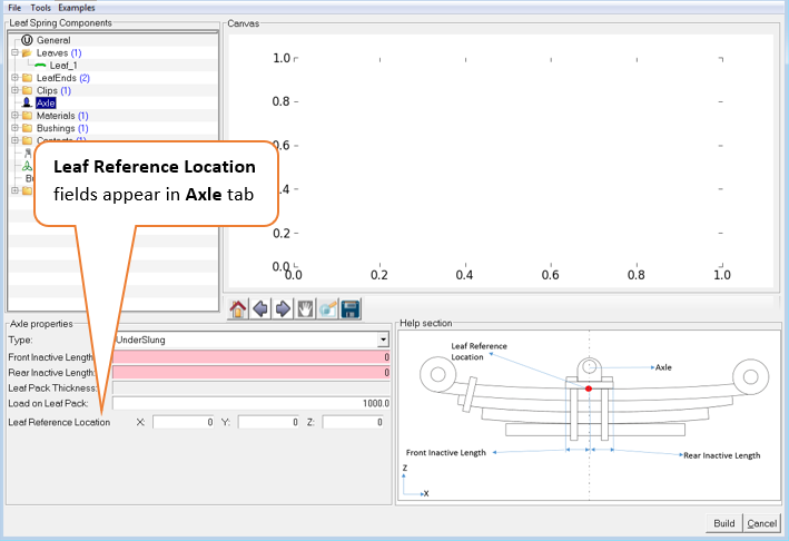

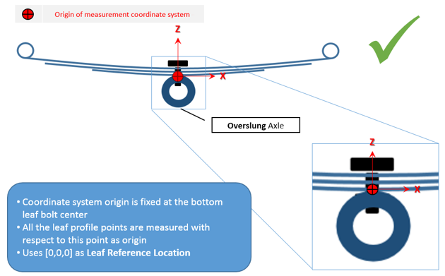

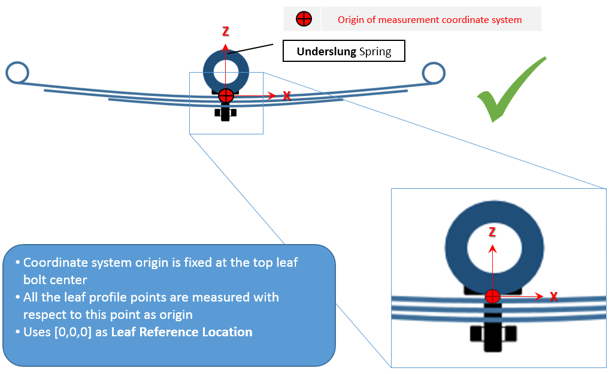

The Leaf Spring Builder creates MotionView MDL leaf-spring models which are only as good as the leaf shapes you input. Therefore it is important to accurately measure the leaf shapes in the required coordinate system. The coordinate system, its origin and orientation, needs to follow certain rules to be useful in creating a leaf-spring from the Leaf Spring Builder.- Measuring a Leaf Spring in Free Shape

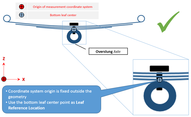

- In Free Shape, the leaves are already assembled into a pack, but not
installed in the vehicle. Hence, all of the leaves together form a
single unit. In this condition, the measurements need to be made in a
consistent coordinate system. Also, it is necessary to input a correct

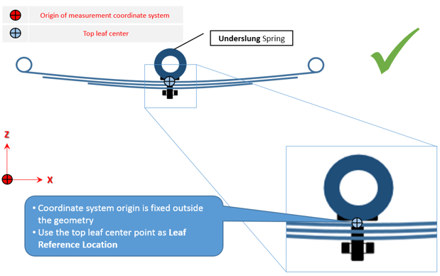

Leaf Reference Location under the Axle tab. The Leaf Reference Marker
will be created at this location.
Figure 4. Leaf Reference Location in Axle Component Properties

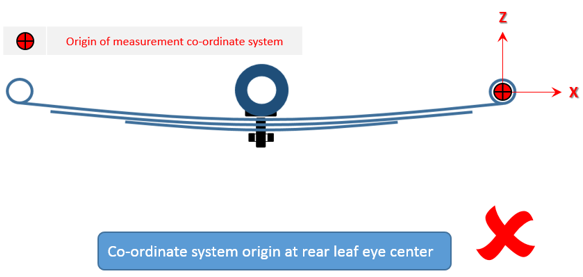

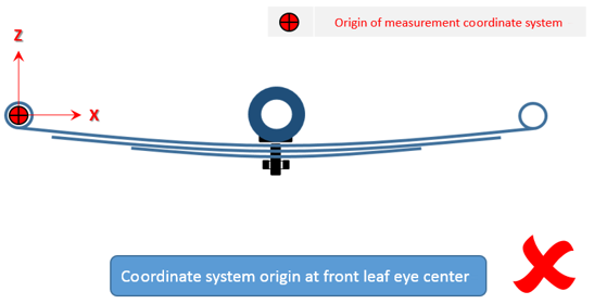

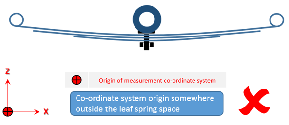

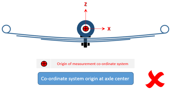

- Unacceptable Selections:
Figure 9. Unacceptable selection-1
Figure 10. Unacceptable selection-2
Figure 11. Unacceptable selection-3
Figure 12. Unacceptable selection-4

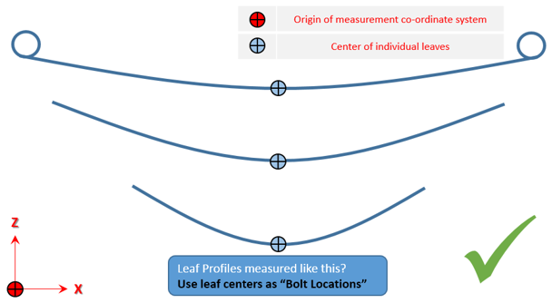

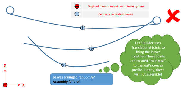

Measuring a Leaf Spring in Pre-Assembly Shape

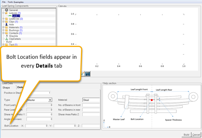

Leaves in the Pre-Assembly Shape condition are measured as independent entities. A common coordinate system needs to be chosen for all the leaves. The Leaf Builder takes an additional input called Bolt Location in the Pre-Assembly Shape condition, which is used to line up the leaves along a common vertical axis before they are bolted together in a MotionSolve simulation to create the assembled leaf pack.
Figure 13. Bolt Location in Leaf Details

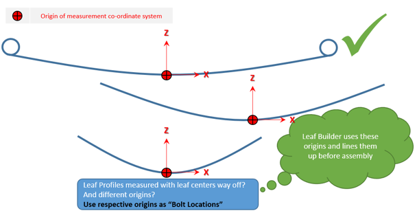

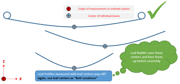

- Acceptable Selections:
- The bolt hole axis of each leaf must be parallel to every other leaf and
he z-axis. The vertical locations of each leaf will be offset by
MotionSolve during assembly, such that
there is no contact between leaves.
Figure 14. Acceptable Selection for Pre-Assembly-1
Figure 15. Acceptable Selection for Pre-Assembly-2
Figure 16. Acceptable Selection for Pre-Assembly-3 - Unacceptable Selection:
Figure 17. Unacceptable Selection for Pre-Assembly-1

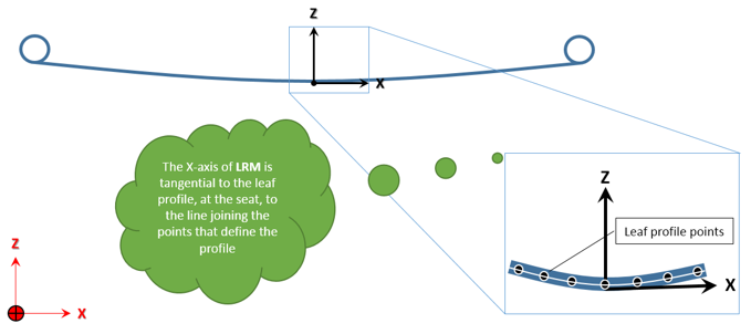

The Leaf Reference Marker (henceforth referred to as LRM in this section) is the coordinate system in which all the points of the leaf profiles are created in MotionView. To move/orient a leaf spring, you can simply move and/or reorient the LRM.
Figure 18. Leaf Reference Marker Location
- Free Shape: Leaf Reference Location as input by the user, top leaf center for underslung spring and bottom leaf center for overslung spring.
- Pre-Assembly Shape: Top leaf bolt location for underslung spring and bottom leaf bolt location for overslung spring.
The Leaf Builder uses the Leaf Reference Marker-origin (location) as the point where the Axle is attached.

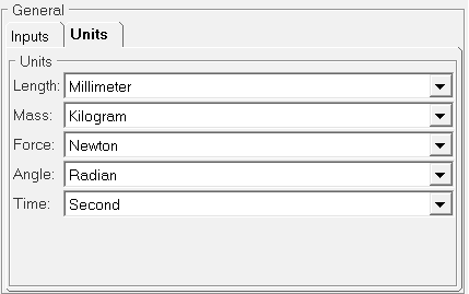

Units
Figure 19. General - Units Tab
Units for Leaf Property File (*lpf)
$---------------------------------------------------------UNITS
[UNITS]
(BASE)
{LENGTH FORCE ANGLE MASS TIME}
MILLIMETER NEWTON RADIAN KILOGRAM SECOND
