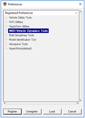

- From the Menu bar, select .
- Choose the MBD-Vehicle Dynamics Tools profile and click
Load.
Figure 2. - Select Vehicle Tools from the Menu bar and choose the
Updated Model option.

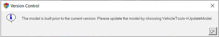

The Need for an Update Model Utility
The Update Model utility complements the backward compatibility of models that are built using previous versions of HyperWorks. In order to roll out new features or enhancements, specifically for vehicle models that were built using one of the MDL Libraries (Car/Small truck and Heavy Truck), updating the model or tweaking it becomes necessary. For example: replacing older Auto Entities like AutoMFTire with the new AutoTire entity or updating the AltairDriver system to include changes from the newer versions.

- Update Model works based on the model's version number and content. If you load an older model and save it from HyperWorks v2020, the *BeginMDL() statement at the beginning of the MDL will now contain a 2020.0-version number. Since the Update Model is based on the version number, it will not update models with a 2020 version number.
- Update Model searches for entities to update using the standard varnames employed by the MDL libraries. If your model was NOT built using the Model wizard and MDL Library or if you modified varnames (for example, “steering” instead of ”sys_steering”), then the model update will be incomplete for your model.
