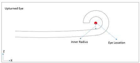

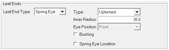

Spring Eye

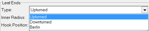

- Type
- Defines the type of Spring Eye.
Figure 2. Available selections for spring eye- Upturned

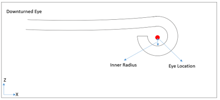

Figure 3. - Downturned

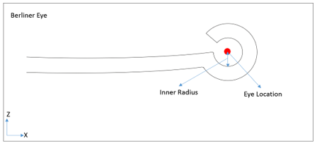

Figure 4. - Berliner
Figure 5.
- Upturned
- Inner Radius
- Defines the leaf end radius.
- Eye Position
- Defines either rear or front position of the leaf end.
- Bushing
- By selecting the bushing option, a new option Eye
Bushing is displayed. The Eye Bushing drop-down menu lists
all the bushings that are added in the Bushings Component.
Figure 6. Bushing Selection in Leaf Ends - Spring Eye Location
- Defines the location of the leaf end. Represents the center of the rear eye
hook with respect to either ‘Leaf_Ref_Loc’ or ‘BOLTLOCATION’ depending upon
the shape condition.Note: If the shape Condition is ‘PRE_ASSEMBLY’, the location should be defined with respect to the ‘BOLTLOCATION’ of ‘MASTER’ leaf.

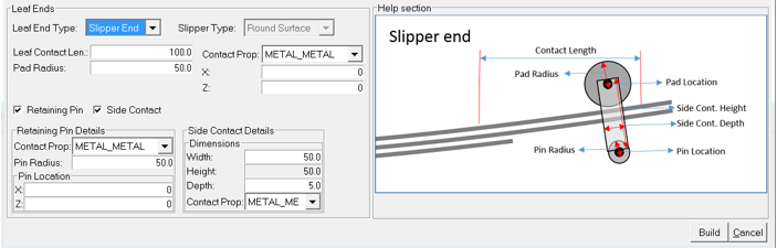

Slipper End
Another available option for leaf ends which is a step away from traditional spring eyes is slipper ends, where one end of the leaf spring or both ends comprises the open leaf which slides in a ‘bracket’ or ‘hanger’ which is welded to the chassis of the trailer.The top surface of the bracket (contact pad) can have many shapes based on the requirement.
Here you can enter data for a primitive shape such as cylinder, for more refined shapes you will have to replace the primitive slipper bracket graphic with a refined one in MotionView.
Figure 8. Leaf Ends - Slipper End Type
- Slipper Type (Round Surface)
- By default, the round surface type is used. It is a cylindrical pin-based slipper end.
- Leaf Contact Len
- Defines an approximate length along the leaf surface that will make contact with the slipper end. It is centered about the slipper center location.
- Pad Radius
- Defines the radius of the cylindrical slipper end.
- X
- Center X location of the slipper end.
- Z
- Center Z location of the slipper end.
- Pin Radius
- Defines the radius of the cylindrical pin.
- X
- Center X location of the retaining pin.
- Z
- Center Z location of the retaining pin.
- Width
- Length of the bracket along Y direction.
- Height
- Length of the bracket along Z direction.
- Depth
- Length of the bracket along X direction.

An example of how a Front Leaf End block with Slipper End is represented in a TiemOrbit file format is shown below:$-------------------------------------FRONT_LEAF_END
[FRONT_LEAF_END]
BLOCKNAME = ‘FRONT_LEAF_END’
ENDTYPE = ‘SLIPPER END’
SLIPPERTYPE = ‘ROUND SURFACE’
(PINDATA)
PINCONTACTPROP = ‘METAL_METAL’
PINLOCX = -530.0
PINLOCZ = 110.0
PINRADIUS = 20.0
(SIDECONTACTDATA)
DEPTH = 5.0
HEIGHT = 50.0
SIDECONTACTPROP = ‘METAL_METAL’
WIDTH = 85.0
(SLIPPERDATA)
LEAFCONTACTLEN = 100.0
PADCONTACTPROP = ‘METAL_METAL’
PADLOCX = -530.0
PADLOCZ = 190.0
PADRADIUS = 30.0
