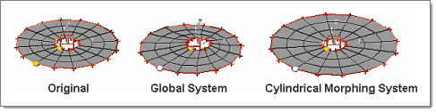

| morphing system | Choose between
morphing based on a local coordinate system, or the global
system. This option transforms the perturbations passed from handles to nodes using the selected morphing system. For rectangular systems this has no effect, but for cylindrical and spherical systems handle movements in the radial, theta, and so on, directions will be applied to influenced nodes in the radial, theta, and so on, direction. Thus, when you move a handle radially, the nodes which it influences will move radially as well instead of simply following the handle. This option is similar to the use system for nodes option for along xyz in the Morph panel, but it applies to all morphing operations. In Figure 1, notice how the morphing differs after
moving a handle on the outer edge domain. When using a
global system, the nodes on the edge domain are given the
same x-y-z perturbations as the handle. When using a
cylindrical system, the movement of the handle is converted
into r-theta-z components which are then applied to each
node on the edge domain in a relative fashion. Thus, the
radial morphing of the handle results in the radial morphing
of the edge domain.
![]() Figure 1. |
