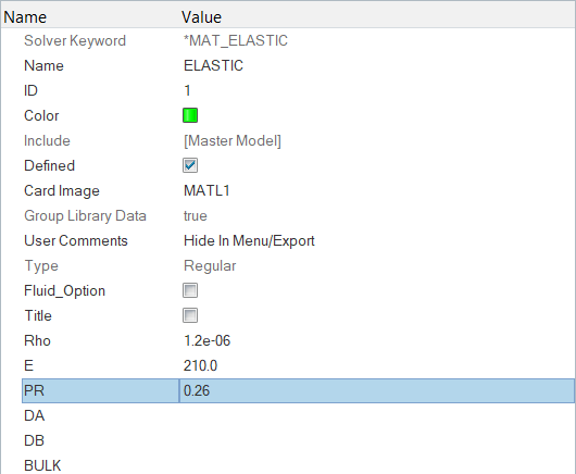

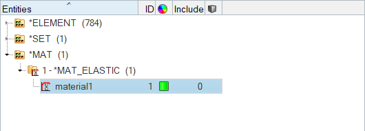

Define the *MAT_ELASTIC Material
In this step, you will define a new material for the A-pillar and head.

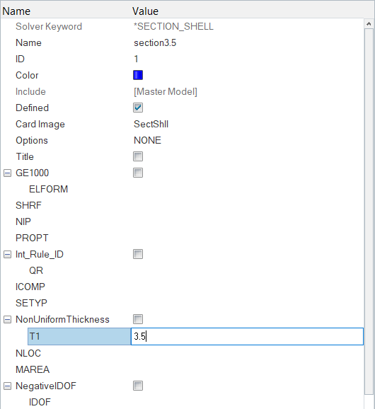

Define *SECTION_SHELL
In this step, you will define a property with a 3.5 mm thickness for the A-pillar.

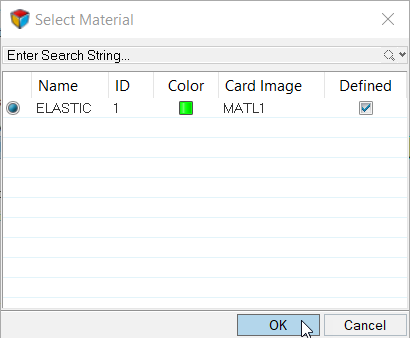

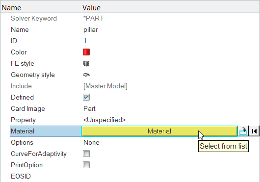

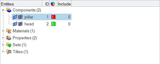

Define *PART for the A-pillar
In this step, you will define the *PART for the A-pillar in the model.

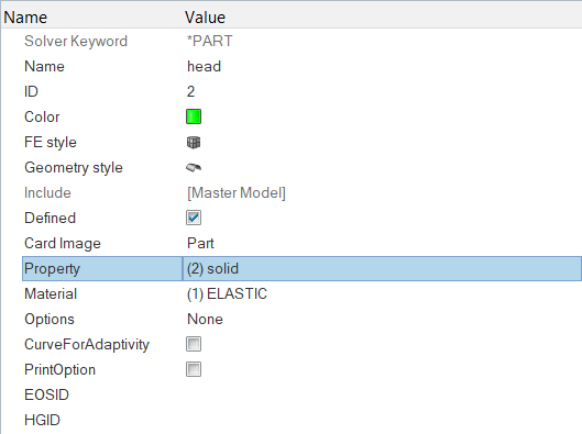

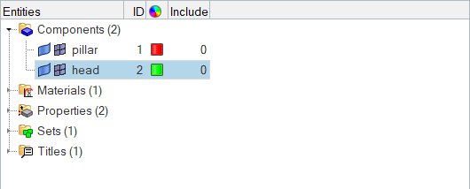

Define *PART for the Head
In this step, you will define the *PART for the head of the model.
