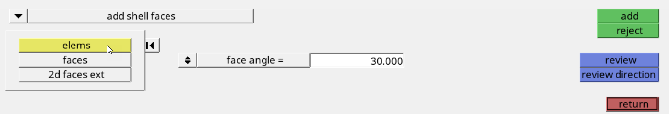

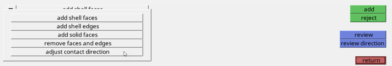

- Add Subpanel
- While the Interfaces panel, add subpanel has several main and secondary entity types to choose from in order to specify the LS-DYNA main or secondary set for a *CONTACT, only the valid main and secondary types are selectable for the particular contact you are creating.
- Review Contacts
- Review contacts by clicking review in the Interfaces panel, add subpanel.

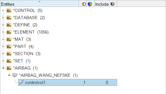

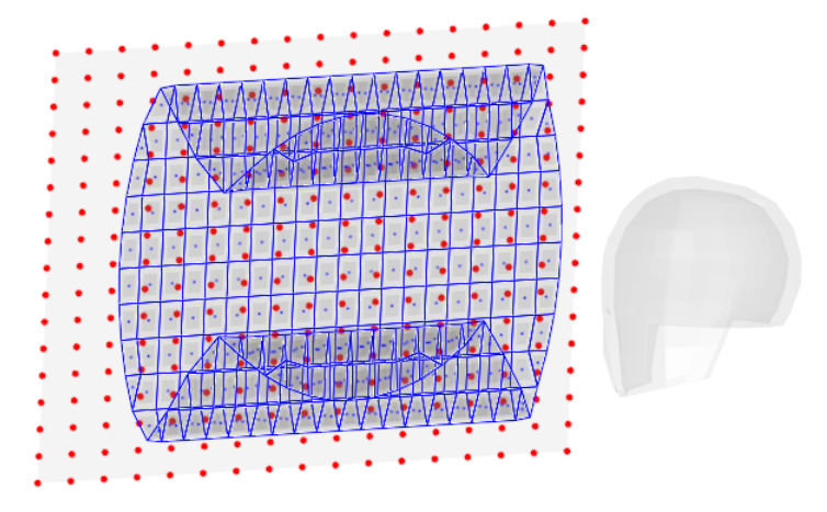

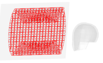

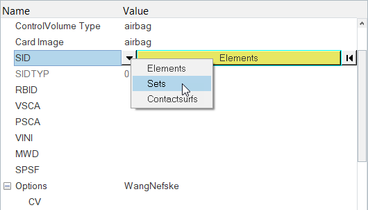

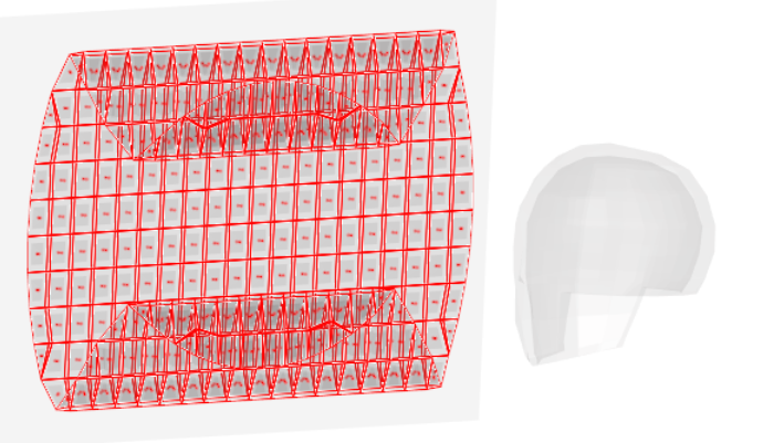

Define *AIRBAG_WANG_NEFSKE
In this step, you will define *AIRBAG_WANG_NEFSKE for the airbag mesh geometry.

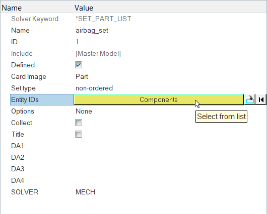

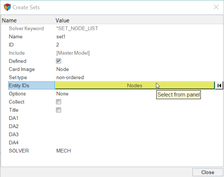

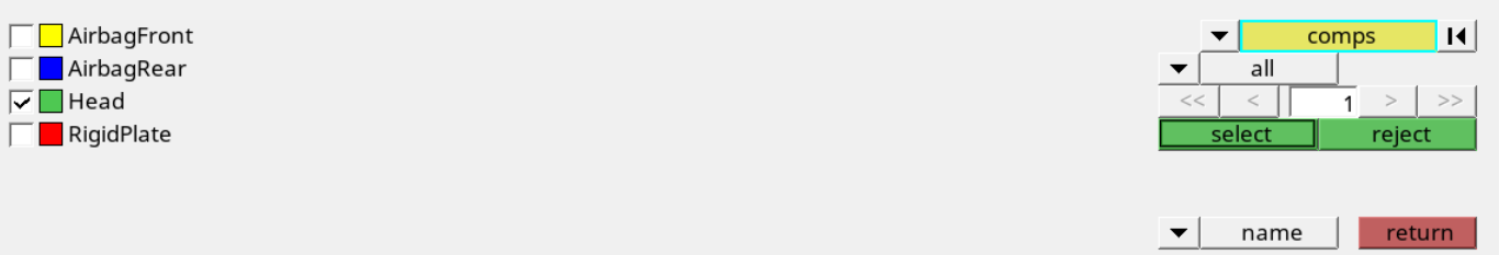

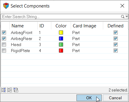

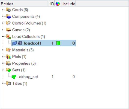

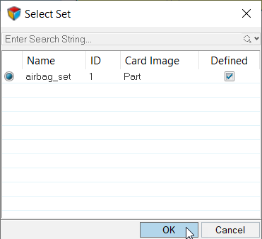

Create a set of parts, *SET_PART_LIST, containing the AirbagFront and
AirbagRear components.

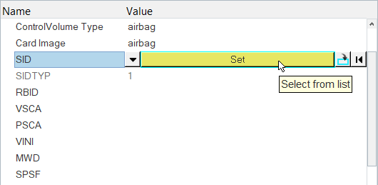

Define the airbag (*AIRBAG_WANG_NEFSKE).

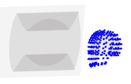

Define an initial velocity of 3 mm/ms in the negative xdirection for the head
with *INITIAL_VELOCITY_GENERATION.

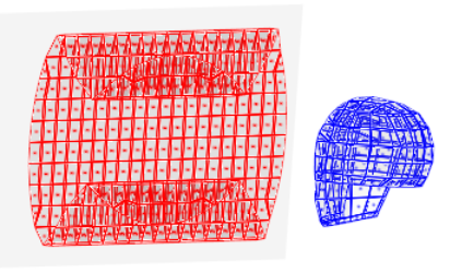

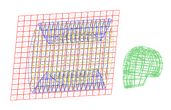

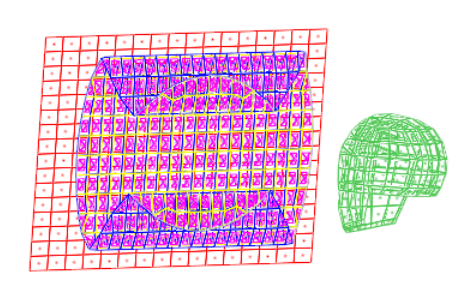

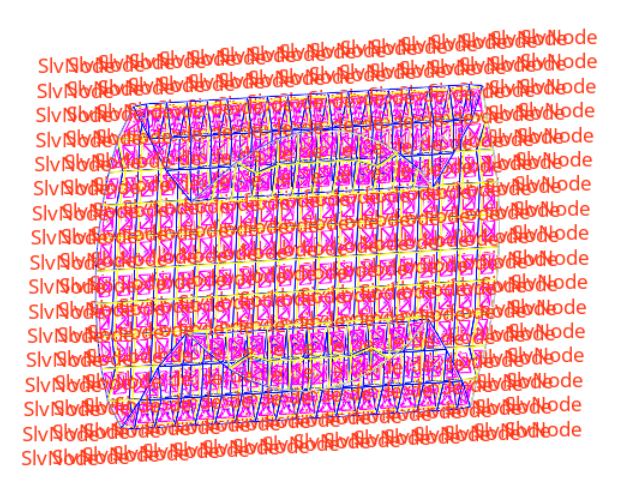

Define a Contact Between the Airbag and the Head
In this section, you will define a contact between the airbag and the head with *CONTACT_AUTOMATIC_SURFACE_TO_SURFACE.

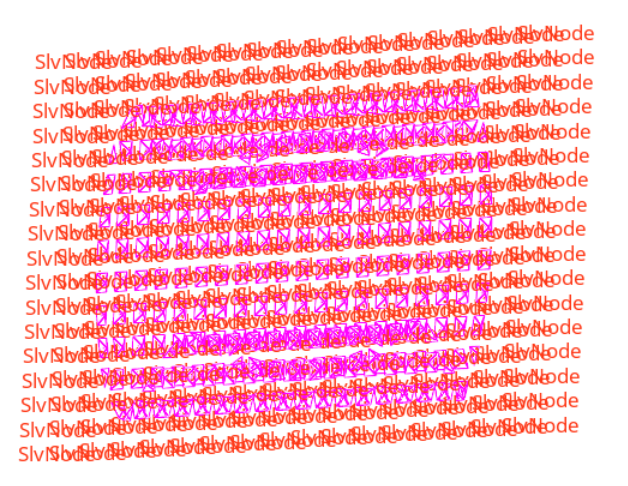

Define a Contact Between the Plate and the Airbag
In this step, you will define a contact between the plate and the airbag with *CONTACT_NODES_TO_SURFACE.

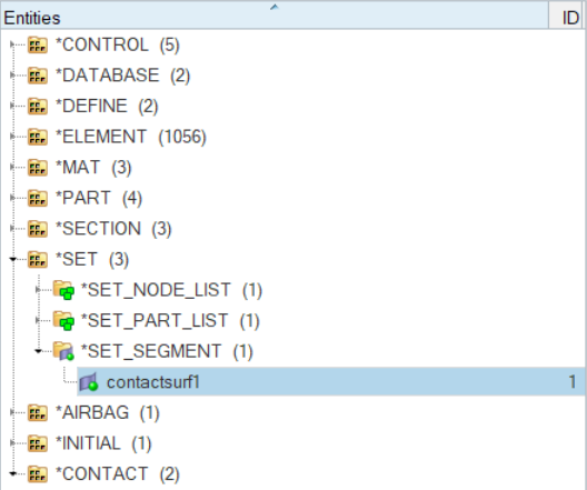

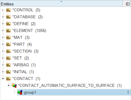

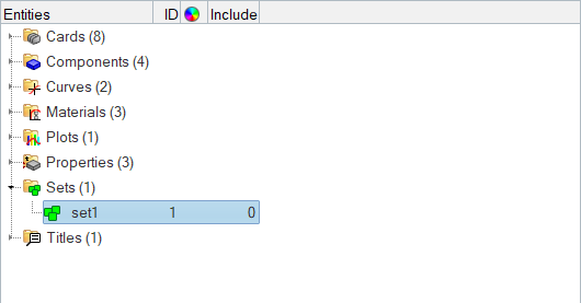

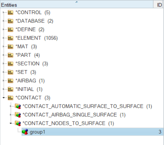

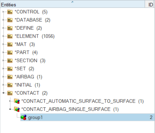

Review the Created Solver Entities
In this step, you will review the created solver entities using the Solver Browser.
