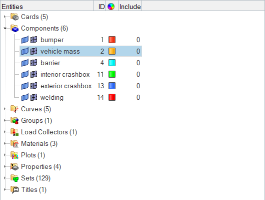

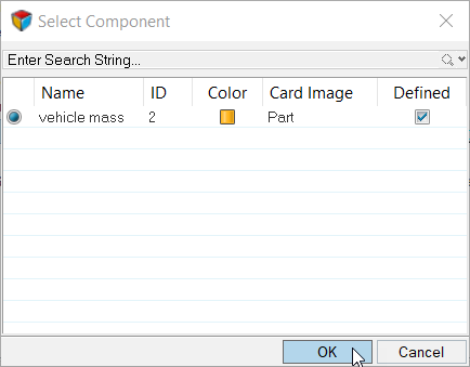

Define *PART_INERTIA
In this step, you will define *PART_INERTIA for the vehicle mass component to partially take into account the inertia properties and mass of the missing parts.

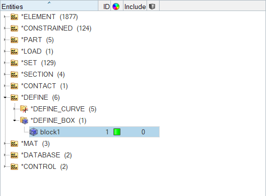

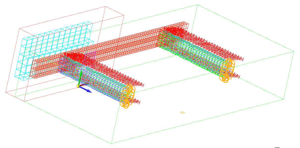

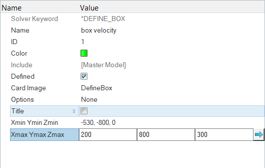

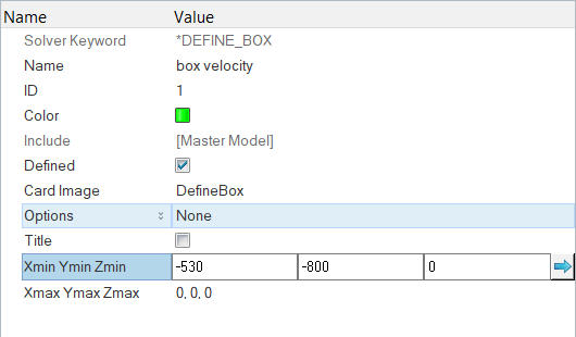

Create a *DEFINE_BOX that Contains Non-Barrier Nodes
In this step, you will create a *DEFINE_BOX in Engineering Solutions that contains all nodes except barrier nodes.

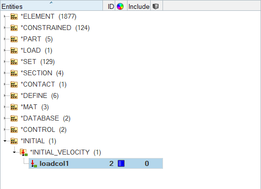

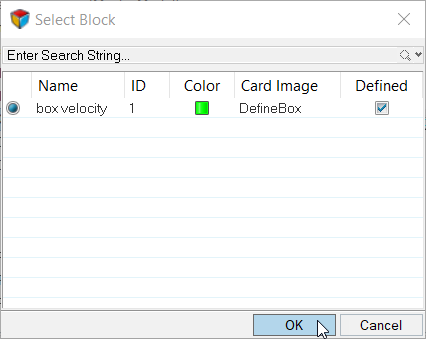

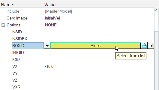

Create Initial Velocity
In this tutorial, you will create initial velocity on all nodes except barrier nodes.

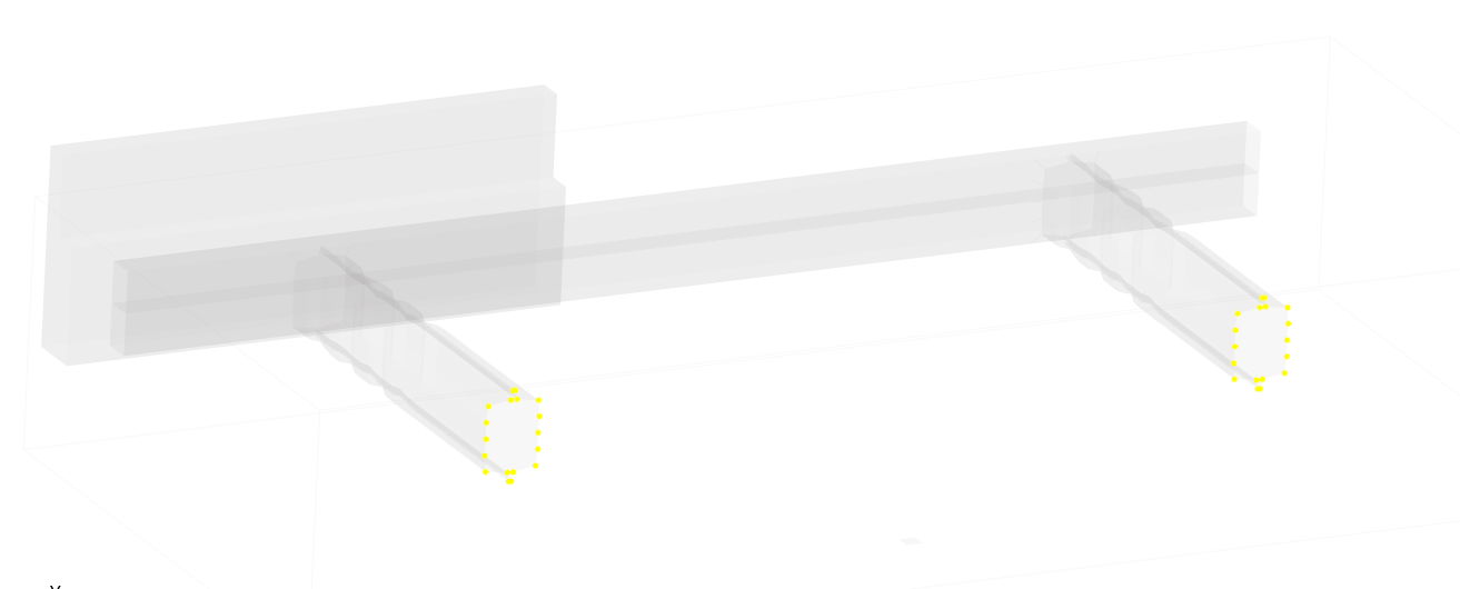

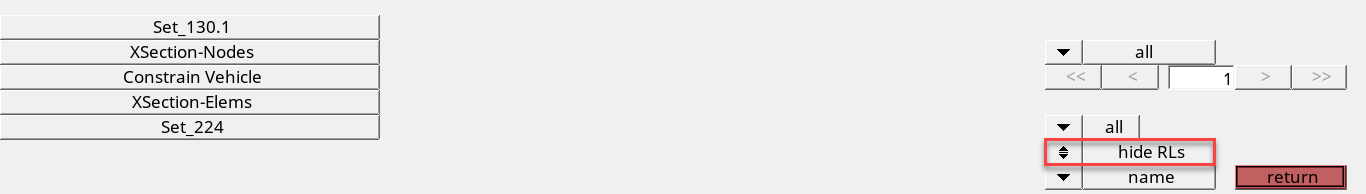

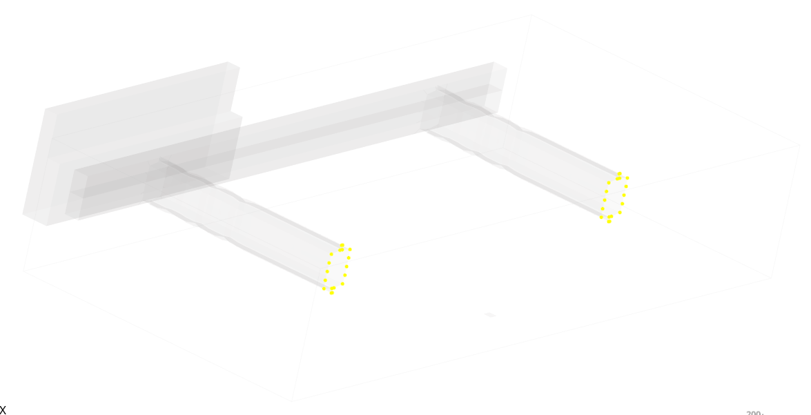

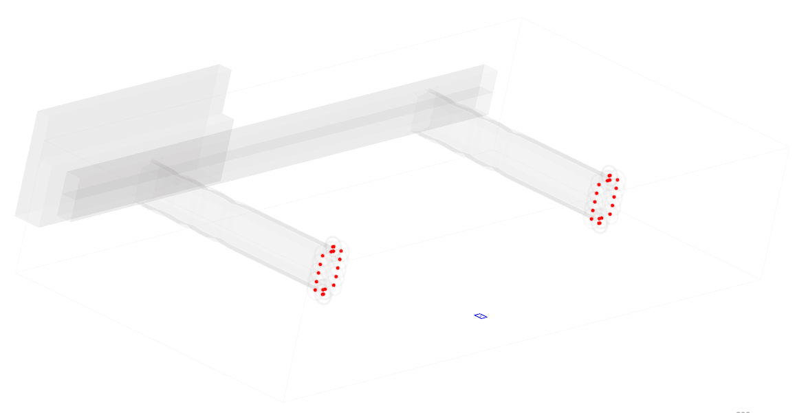

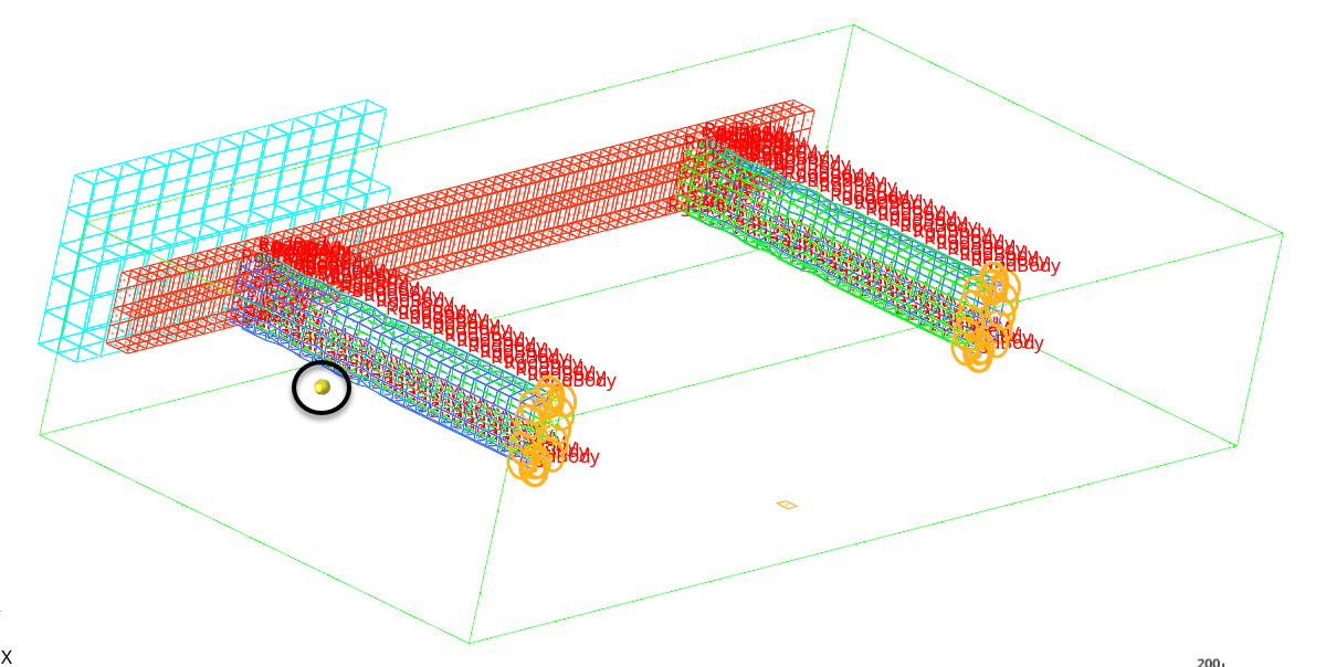

View the Nodes in the Node Entity Set
In this step, you will view the closest nodes which are in the pre-defined node entity set (*SET_NODES_LIST) named Constrain Vehicle using two methods.
Method 1
Method 2

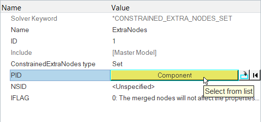

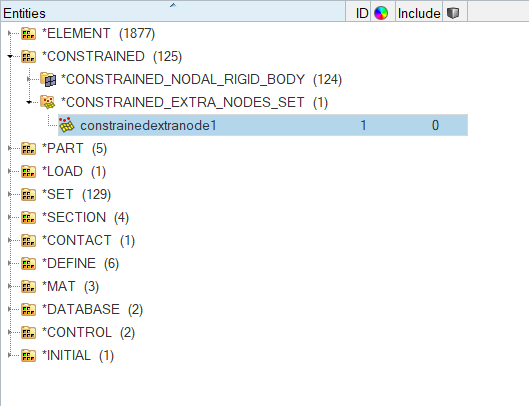

Create *CONSTRAINED_EXTRA_NODES_SET
In this step, you will create a *CONSTRAINED_EXTRA_NODES_SET.
Define Nodes in the Constrain Vehicle
In this step, you will define the nodes in the Constrain Vehicle set to be a part of the vehicle mass rigid body.
- For NSID, click .
- In the Select Set dialog, select Constrain Vehicle and then click OK.

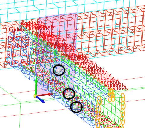

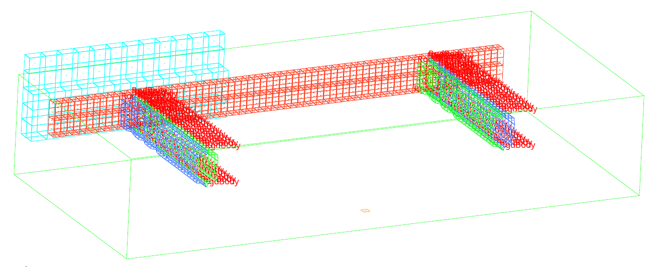

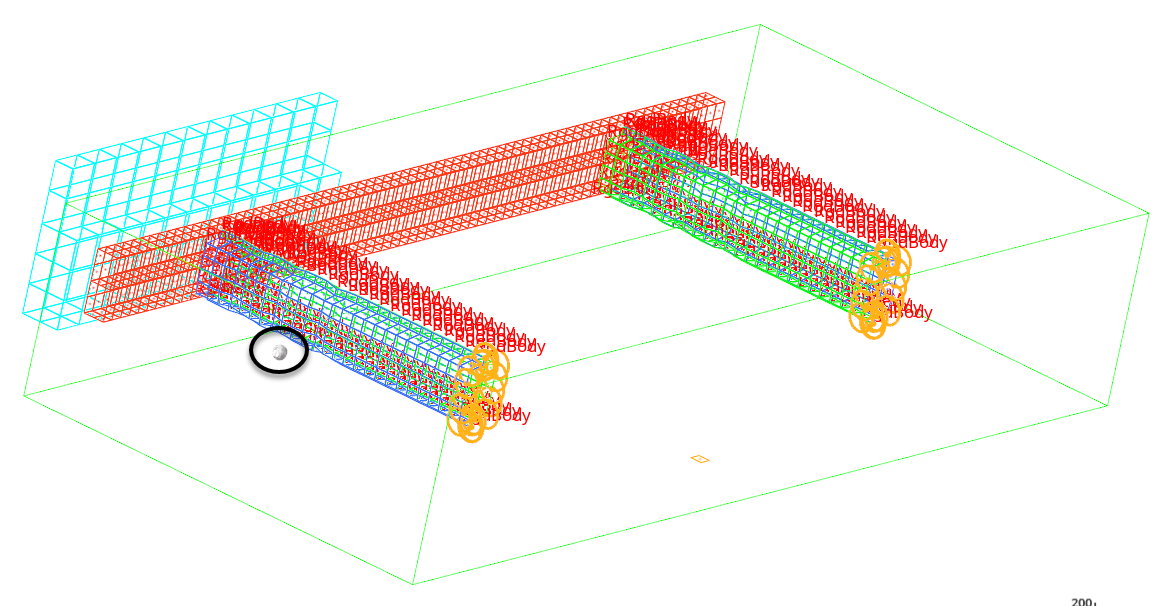

View Extra Nodes of the Vehicle Mass Rigid Body
In this step, you will view the extra nodes that are a part of the vehicle mass rigid body.

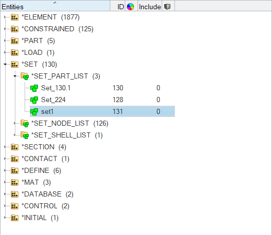

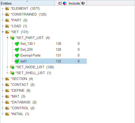

Create an Entity Set
In this step, you will create an entity set, *SET_PART_LIST, for the vehicle mass component.

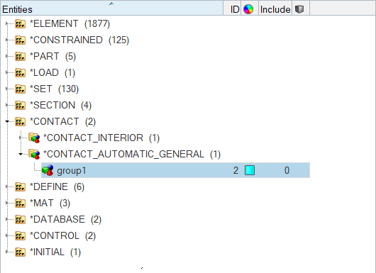

Create a *CONTACT_AUTOMATIC_GENERAL Contact
In this step, you will create a *CONTACT_AUTOMATIC_GENERAL contact.

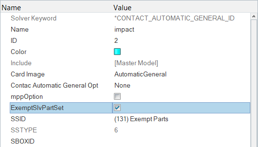

Define Secondary Surface
In this step, you will define the secondary surface with secondary set type 6, part set ID for exempted parts.
In this step, you will create an entity set, *SET_PART_LIST, to specify the elements that will contribute to the cross-sectional force results.

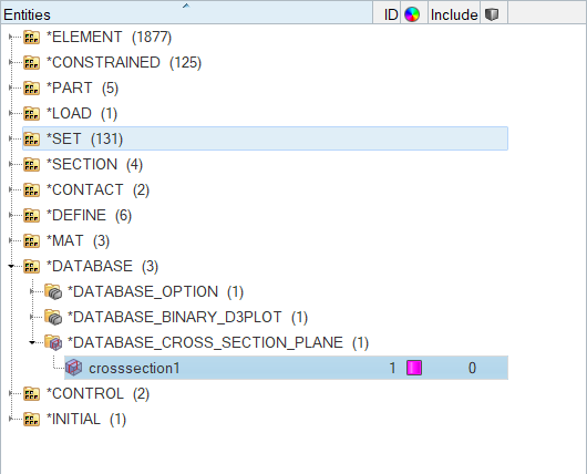

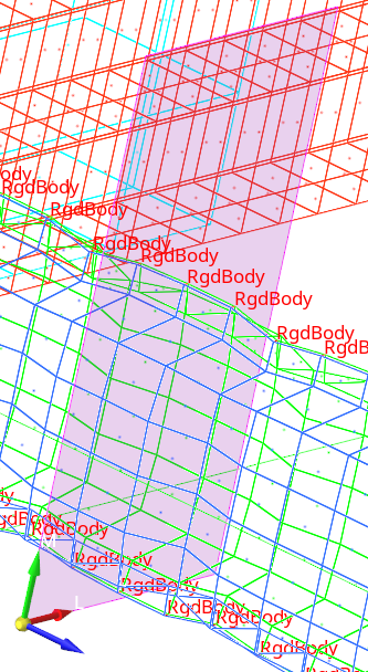

Define a Section
In this step, you will define a section by creating a *DATABASE_CROSS_SECTION_PLANE.

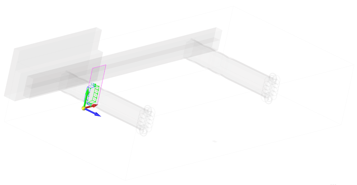

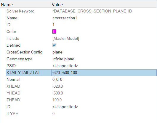

Define the Location and Size of the Section Plane
In this step, you will define the location and size of the section plane.

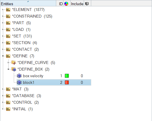

Create a *DEFINE_BOX that Contains Barrier and Bumper Nodes
In this step, you will create a *DEFINE_BOX containing the nodes making up the barrier and the left side of the bumper.

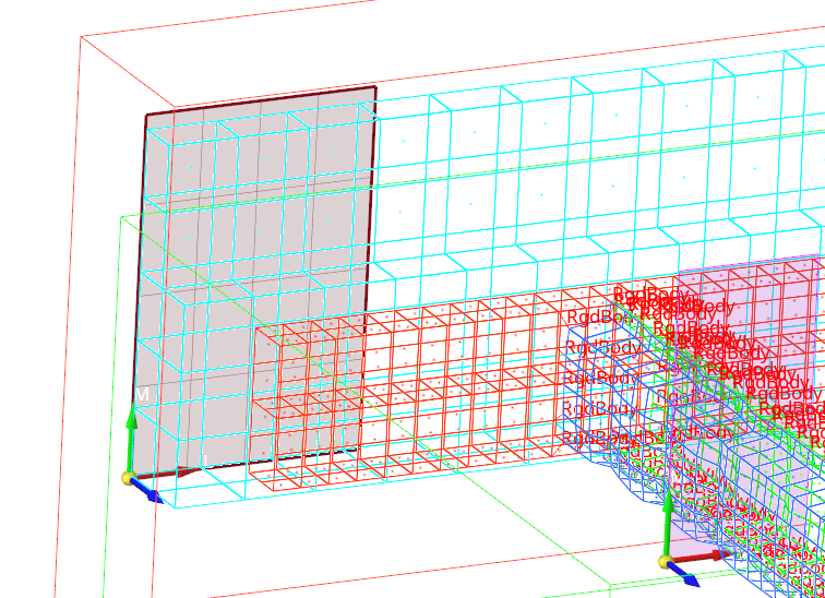

Create a *RIGIDWALL_PLANAR_FINITE
In this step, you will define a Engineering Solutions group by creating *RIGIDWALL_PLANAR_FINITE.

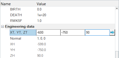

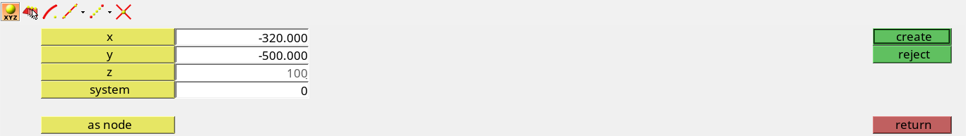

Define the Location and Size of the Rigid Wall
In this step, you will create a node from the create nodes panel and then select it for the base node.
Specify Nodes as Secondary to the Rigid Wall
In this step, you will use the Entity Editor for the rigid wall to specify the nodes in the *DEFINE_BOX half model as secondary to the rigid wall.

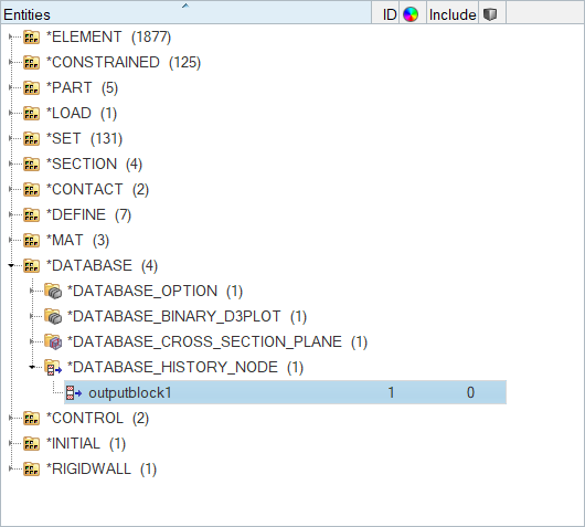

Specify Nodes to be Output
In this step, you will specify some nodes to be output to the ASCII NODOUT file with *DATABASE_HISTORY_NODE.
