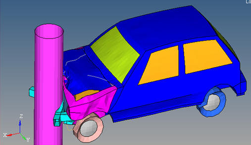

RD-T: 3550 Simplified Car Front Pole Impact
This tutorial demonstrates how to simulate frontal pole test with a simplified full car.
- UNITS: Length (mm), Time (s), Mass (ton), Force (N) and Stress (MPa)
- Simulation time: Engine file (_0001.rad) [0 - 0.0601 ms]
- An initial velocity of 15600 mm/s is applied on the car model to impact a rigid pole of radius 250 mm.

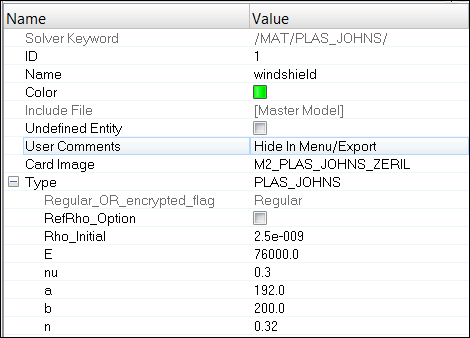

- Elasto-plastic Material /MAT/LAW2 (Windshield)
[Rho_I] Initial Density = 2.5x10-9 ton/mm3
[E] Young's Modulus = 76000 MPa
[nu] Poisson's Ratio = 0.3
[a] Yield Stress = 192 MPa
[b] Hardening Parameter = 200 MPa
[n] Hardening Exponent = 0.32

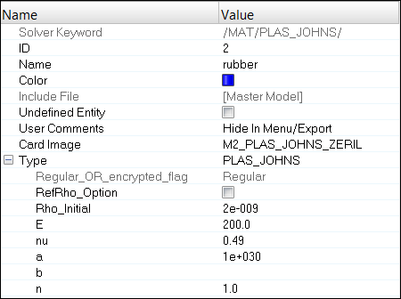

- Elasto-plastic Material /MAT/LAW2 (Rubber)
[Rho_I] Initial Density = 2x10-9 ton/mm3
[E] Young's Modulus = 200 MPa
[nu] Poisson's Ratio = 0.49
[a] Yield Stress = 1e30 MPa
[n] Hardening Exponent = 1

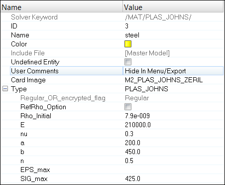

- Elasto-plastic Material /MAT/LAW2 (Steel)
[Rho_I] Initial Density = 7.9x10-9 ton/mm3
[E] Young's Modulus = 210000 MPa
[a] Yield Stress = 200 MPa
[b] Hardening Parameter = 450 MPa
[n] Hardening Exponent = 0.5
[SIG_max] Maximum Stress = 425 MPa

Create and Assign the Material for Windshield
Create and Assign the Material for Rubber
Create and Assign the STEEL Material

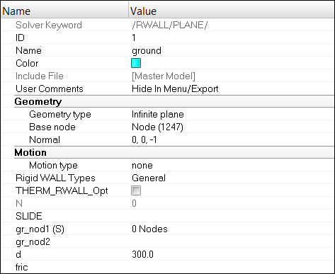

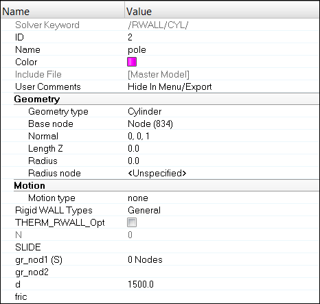

Create an Infinite Plane Rigid Wall
Create a Cylindrical Rigid Wall

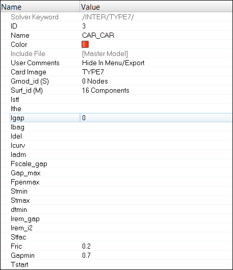

Define the Self Contact (TYPE7)

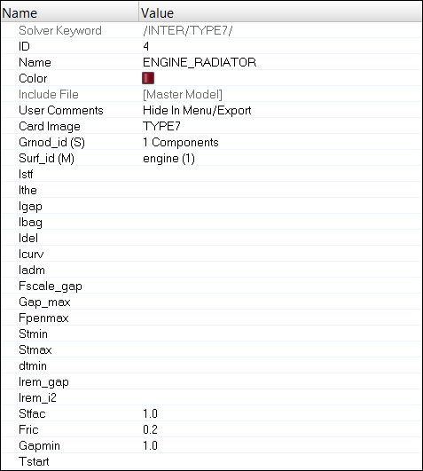

Define the Contact between the Engine and Radiator (TYPE7)

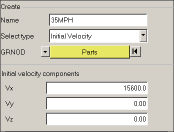

Define the Initial Velocity

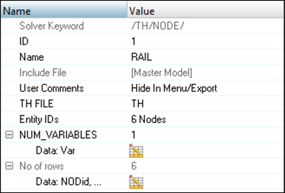

Create Time History Nodes
