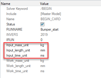

- UNITS: Length (mm), Time (ms), Mass (kg)

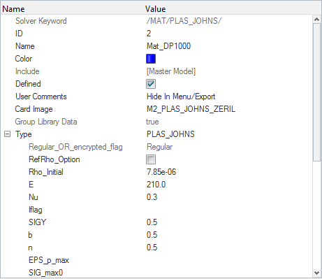

- /MAT/LAW2 (PLAS_JOHNS): for Bumper parts and Crash box parts

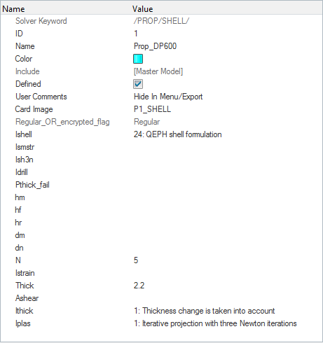

- /PROP/TYPE1 (SHELL): for Bumper beam parts and Crash box parts

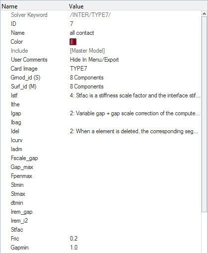

- /INTER/TYPE7: Penalty contact between all versus all

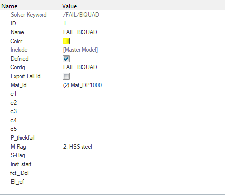

- /FAIL/BIQUAD: to model failure

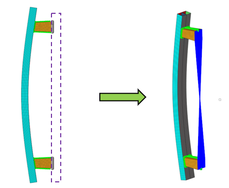

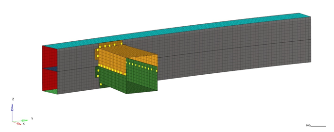

Figure 1. Bumper Model

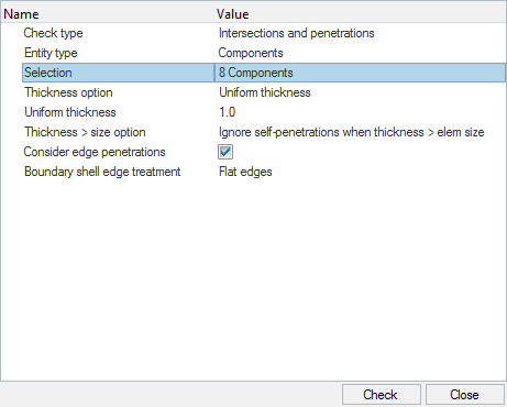

Define Penetration/Intersection Check

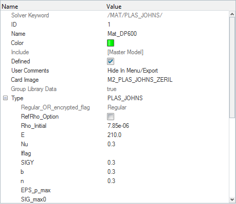

Create Materials
Two materials will be created.
Create Failure to Material Card

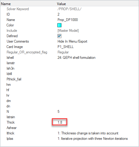

Create the Properties
Two properties will be created.

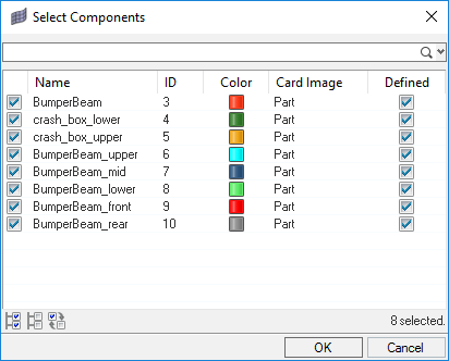

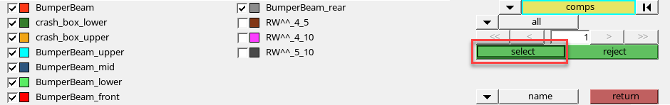

- In the Model Browser, expand the Components folder and left-click on the crash_box* components.
- In the Entity Editor, for Prop_Id, click the Value field <unspecified> to change to Property and select Prop_DP600 and click OK.
- For Mat_Id, click the Value field <unspecified> to change to Material and select Mat_DP600 and click OK.
- In the Model Browser, left-click on the BumperBeam* components.
- In the Entity Editor, for Prop_Id, click the Value field <unspecified> to change to Property and select Prop_DP1000 and click OK.
- For Mat_Id, click the Value field <unspecified> to change to Material and select Mat_DP1000 and click OK.

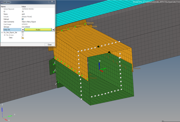

Create Spotwelds
The model has unrealized connectors which will be used to create spotwelds.

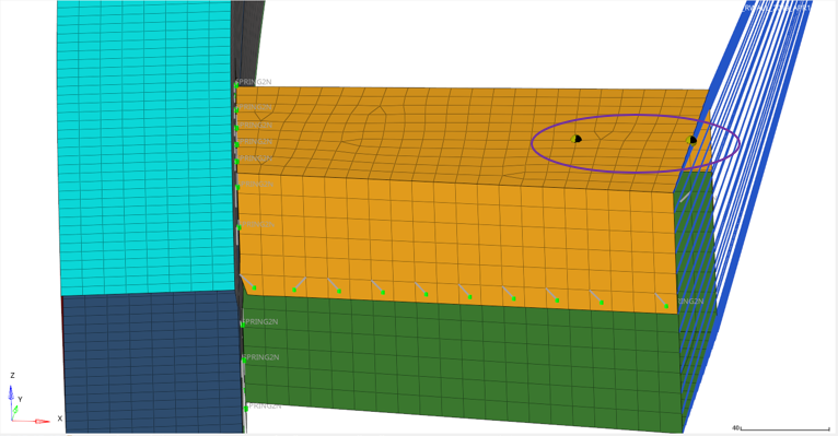

- From 1D page select and toggle the realize option to connect the bumper parts.
- Click connectors and select all.
- Set type= to type2(spring).
- For tolerance and diameter, insert a value of 8 and click realize.
- Click return.

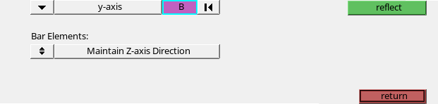

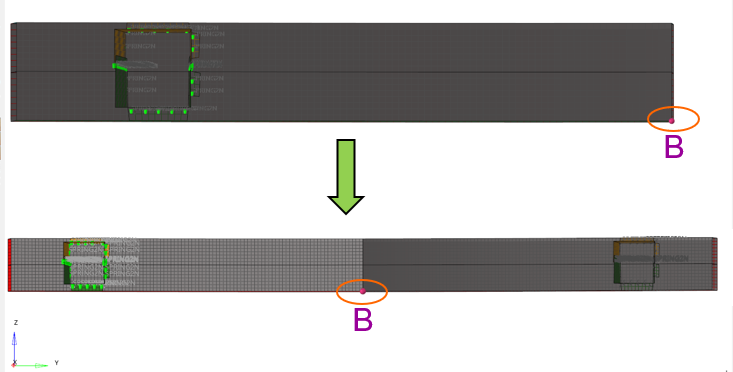

Reflect the Model

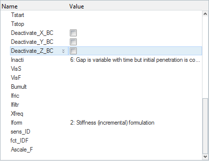

Create the Interface for Penalty Contact

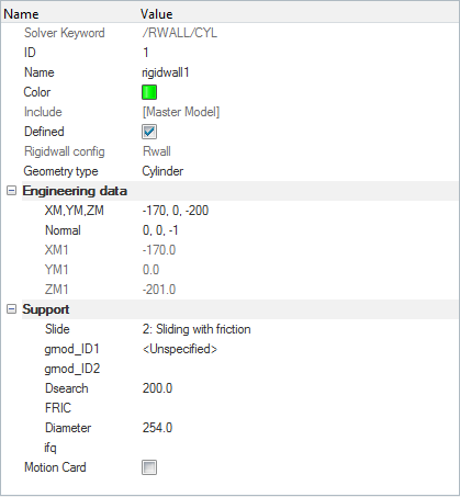

Define the Rigid Wall

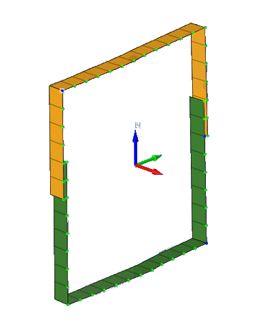

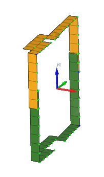

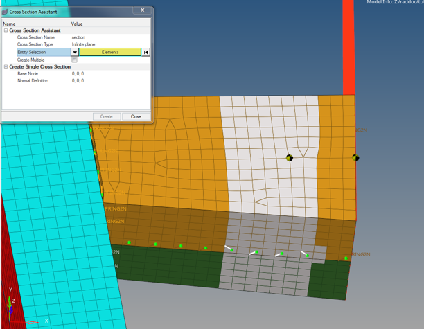

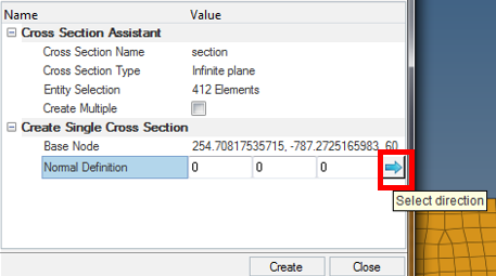

Create a Cross Section
Review the Cross Section
Edit the Cross Section Sets

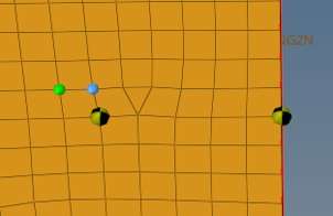

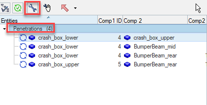

Define 2nd Penetration Check
- From the Tools menu, select Penetration Check.
Click Invoke Penetration check setup Widget icon
- For Entity type, select Groups and select all_vers_all contact group.
- Click Check.

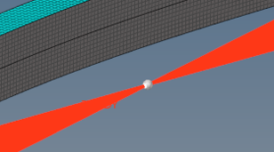

In the Penetrations Browser, click the Review Failed
Elements icon
- Expand the Penetrations folder in the browser and select all_contact to see the elements with the penetrations.
Click Automatic Penetration/Intersection Fix icon
to remove penetrations.
Click Recheck icon
, if there are any penetrations or intersections.

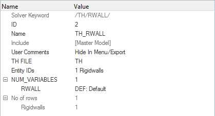

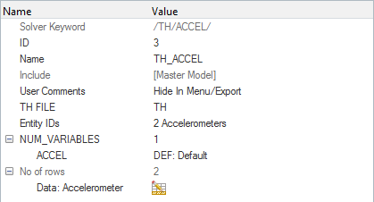

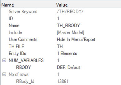

Create Time History Outputs
Three separate time history outputs will be created in this step.

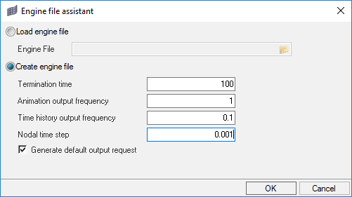

Export the Model
Click or click the Export icon
Click the folder icon
and navigate to the
destination directory where you want to export to.
- For Name, enter bumper_impact and click Save.
- Click the downward-pointing arrows next to Export options to expand the panel.
- Click Export to export the file.
