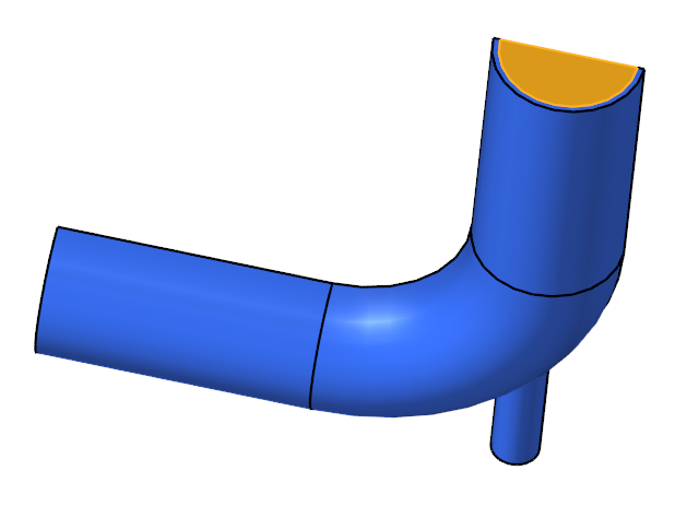

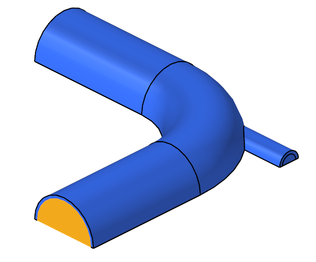

The problem to be addressed in this tutorial is shown schematically in Figure 1. It consists of a mixing elbow made of stainless steel with water entering through two inlets with different velocities and at different temperatures. The geometry is symmetric about the XY midplane of the pipe, as shown in the figure.
Figure 1. Schematic of Mixing Elbow with Stainless-steel Walls

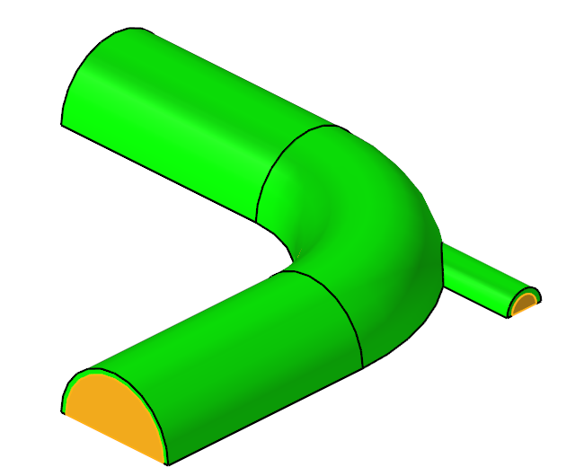

Validate the Geometry
Figure 3.

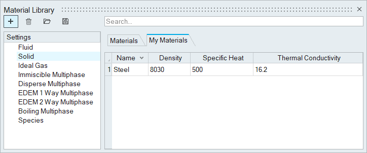

Create a New Material Model
Assign Material Properties

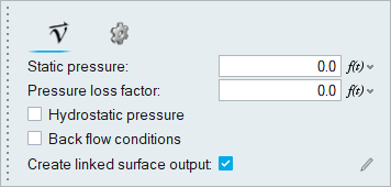

Set Boundary Conditions for the Outlet

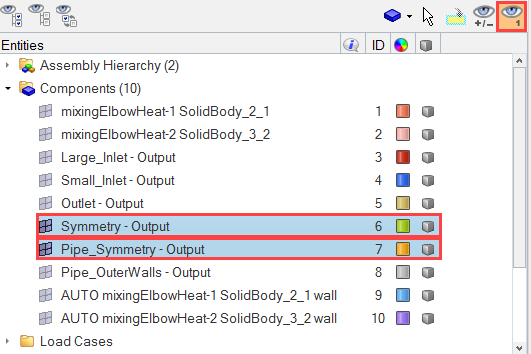

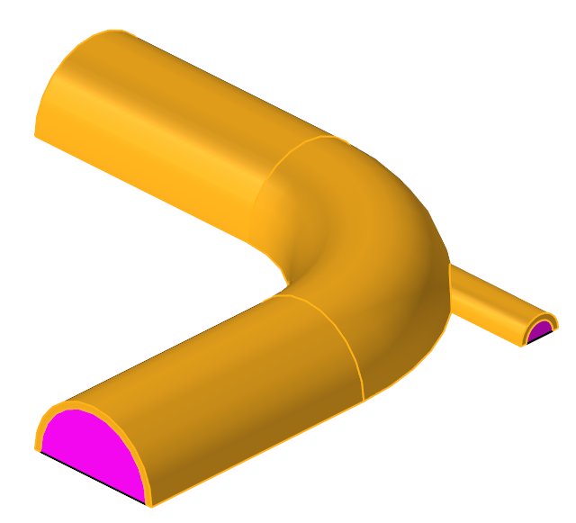

This geometry is symmetric about the XY midplane, and can therefore be modeled with half of the geometry. In order to take advantage of this, the midplane needs to be identified as a symmetry plane. The symmetry boundary condition enforces constraints such that the flow field from one side of the plane is a mirror image of that on the other side.
Set Boundary Conditions for the Outer Pipe Walls

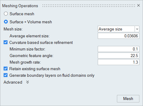

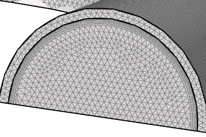

Generate the Mesh

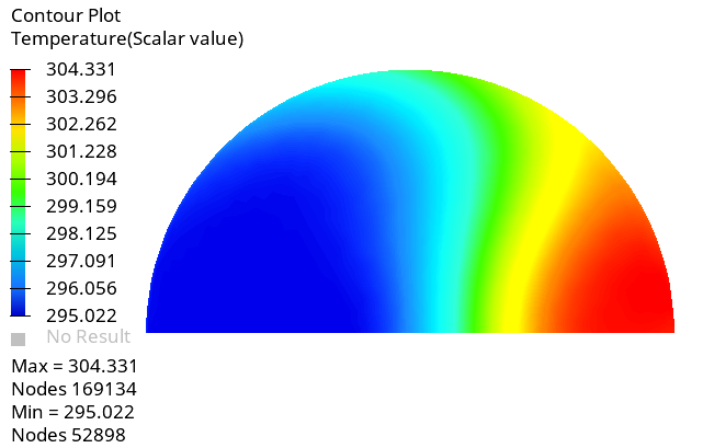

This part of the tutorial shows you how to work with steady state analysis data in HyperView once the solution has converged.

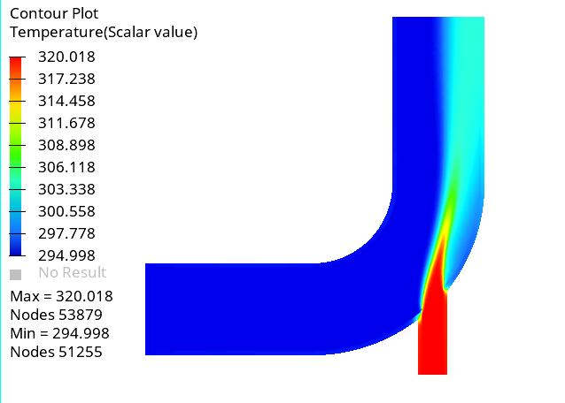

Create Contours for Temperature Distribution
