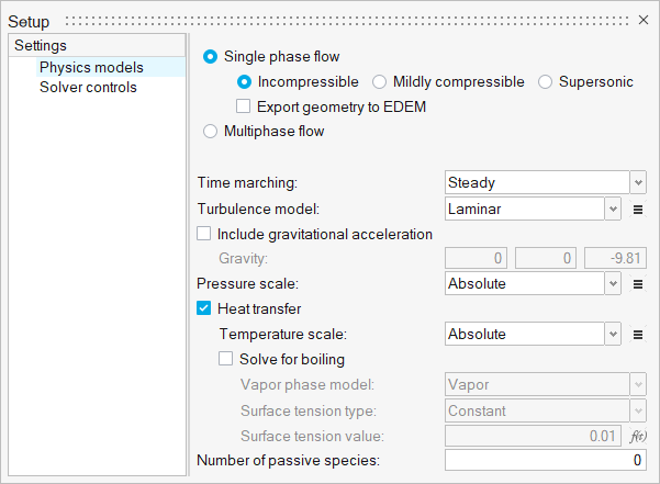

Set Up Flow

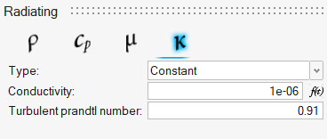

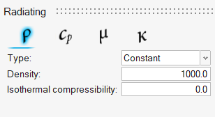

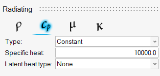

Create Material Models
Assign Material Properties

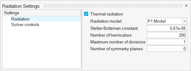

Select the Radiation Model

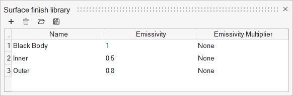

Assign the Emissivity Model

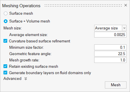

Generate the Mesh

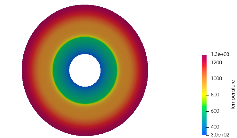

Summary

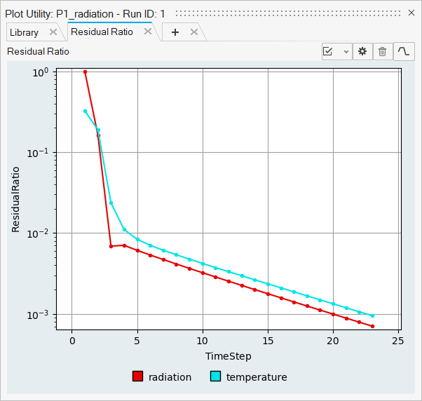

In this tutorial, you learned how to set up and solve a radiation heat transfer simulation using the P1 radiation model. You started by importing the HyperWorks CFD input database and defining the flow and radiation setup. Then, you generated the mesh and submitted the AcuSolve simulation. Once the solution was computed, you created a plot of residual ratios using the plot utility in HyperWorks CFD. Finally, you created a contour plot of temperature distribution on a section cut using HyperWorks CFD Post.
