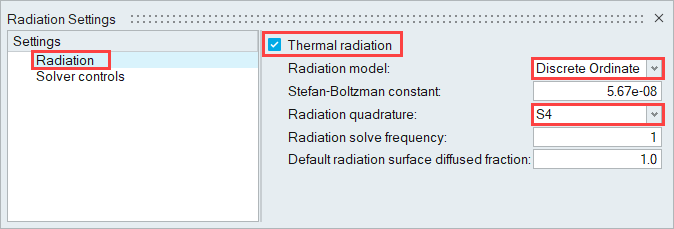

In this step, you will specify the parameters related to the thermal radiation setup.
Define Radiation Model Settings

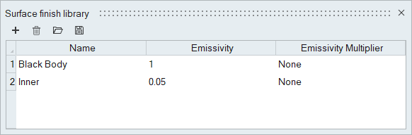

Define the Emissivity Models

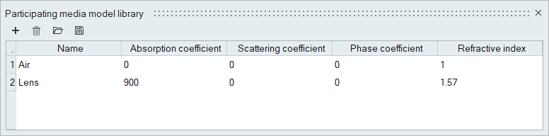

Define the Participating Media Radiation Models

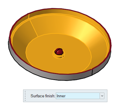

Assign Surface Finish Models

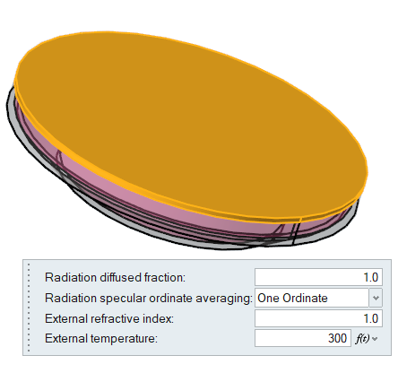

Define the Radiation Interfaces
Since the lens and air are defined as semi-transparent media, the interface between the two will be modeled as a specular interface of type: internal. Accordingly, the outer surfaces of the lens will be modeled as external interface radiation surface.

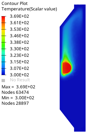

Create Temperature and Incident Radiation Contours on a Section Cut
