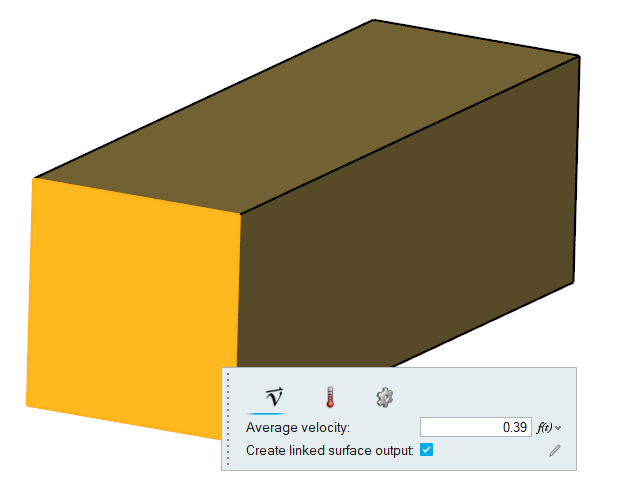

The dimensions of the inlet are 0.03 x 0.04 m; the inlet velocity (v) is 0.39 m/s and the temperature (T) of the fluid entering the inlets is 368.15 K (95 C).

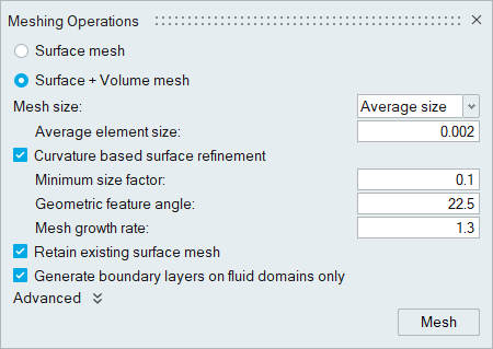

Generate the Mesh

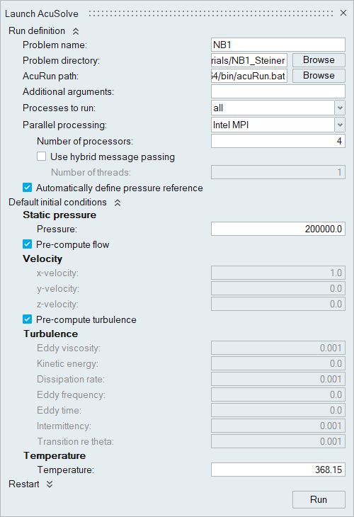

Run AcuSolve

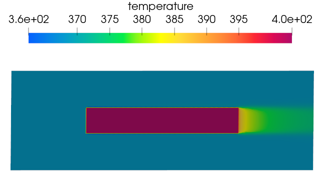

Post-Process the Results with HW-CFD Post
Summary
