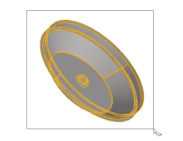

Import and Validate the Geometry
Import the Geometry

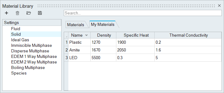

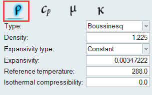

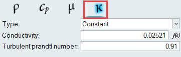

Define the Material Models

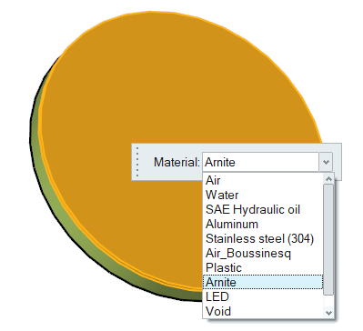

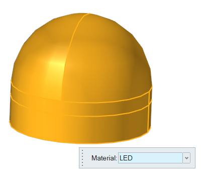

Assign Material Properties

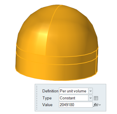

Define the Heat Source

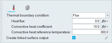

In this problem, all the surfaces are walls and will therefore be assigned the default wall boundary condition. The outer walls of the headlamp will be given a no-slip wall boundary condition with a convective heat flux boundary condition.

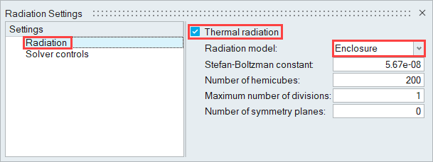

In this step, you will specify the parameters related to the thermal radiation setup.
Define Radiation Model Settings

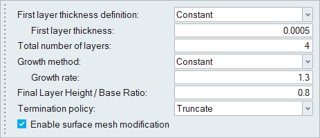

Define the Boundary Layer Controls

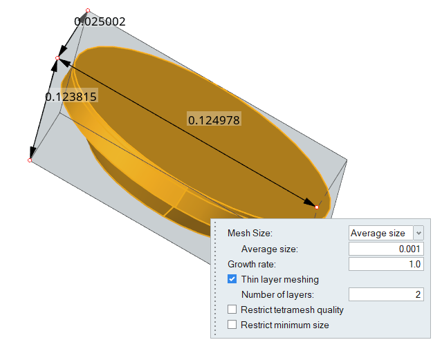

Since the thickness of the housing and the lens solids are small, you will use the thin layer meshing tool so that when the volume mesh is generated, there will be two layers across the thickness of those solids.

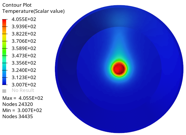

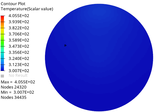

Create a Contour Plot of Temperature

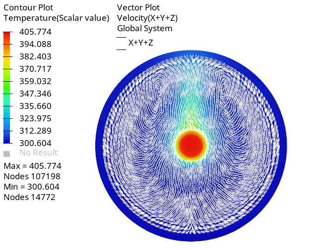

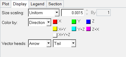

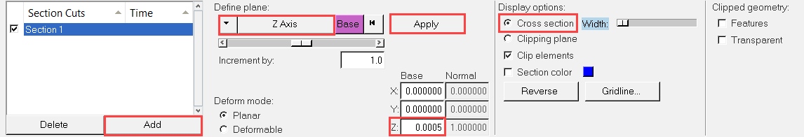

Display Temperature Contours and Velocity Vectors on a Section Cut
In this step, you will create a section cut on the mid-z plane and then display the temperature and velocity vectors on that cross section.
Summary
In this tutorial, you learned how to set up and solve a radiation heat transfer problem in a headlamp using the enclosure radiation model in AcuSolve using HyperWorks CFD. You started by importing the headlamp geometry file, then you set up the simulation parameters and boundary conditions. Once the solution was computed, you processed the results using HyperView, where you created contour plots of temperature and velocity vectors in the fluid domain.
