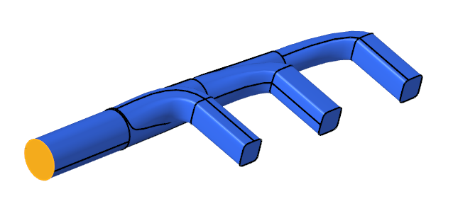

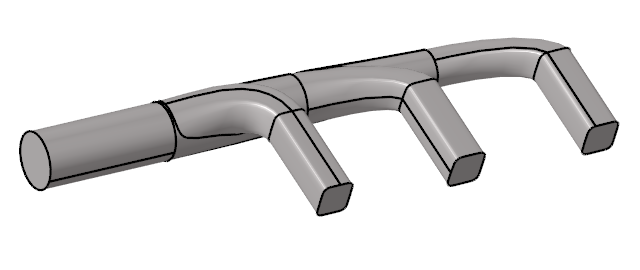

An important step in any CFD simulation is to examine the engineering problem at hand and determine the important parameters that need to be provided to AcuSolve. Parameters can be based on geometrical elements, such as inlets, outlets, or walls, and on flow conditions, such as fluid properties, velocity, or whether the flow should be modeled as turbulent or as laminar.
Figure 1. Schematic of the Problem

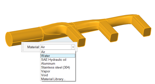

Assign Material Properties

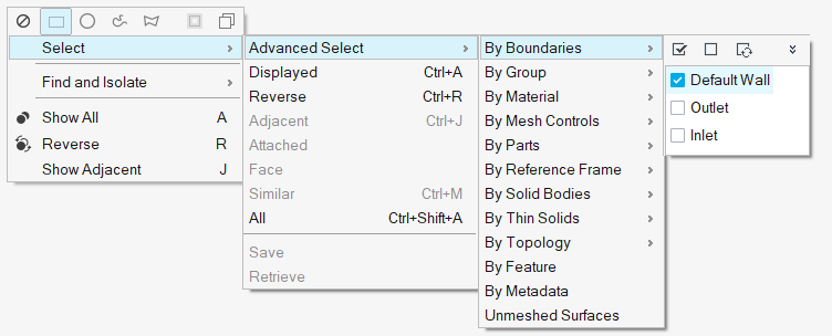

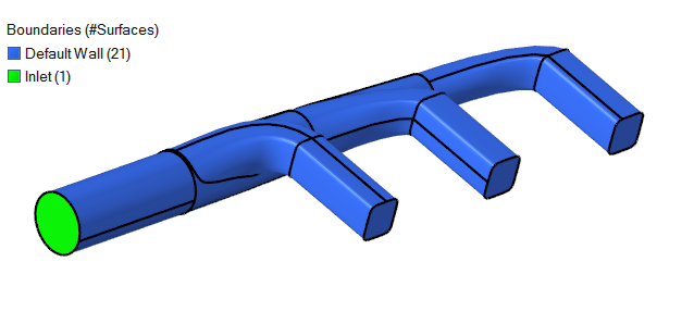

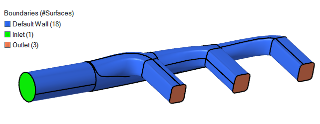

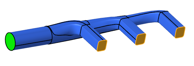

The current model has one inlet, three outlets, and walls for the rest of the surfaces. When a geometry model is imported into HyperWorks CFD, all the surfaces are placed in the Default Wall (i.e. Type = auto_wall). As you start assigning the surface boundary conditions, those surfaces are moved into a new boundary condition group. All the surface boundary condition tools are placed under the Boundaries sub-section of the Flow ribbon.

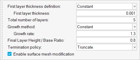

Define the Boundary Layer Mesh Parameters

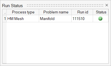

Generate the Mesh

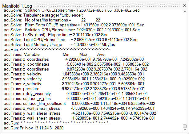

Run AcuSolve

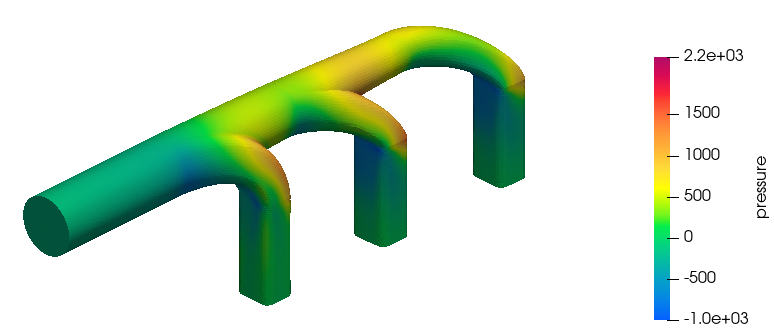

Create Pressure Contours on Boundary Surfaces

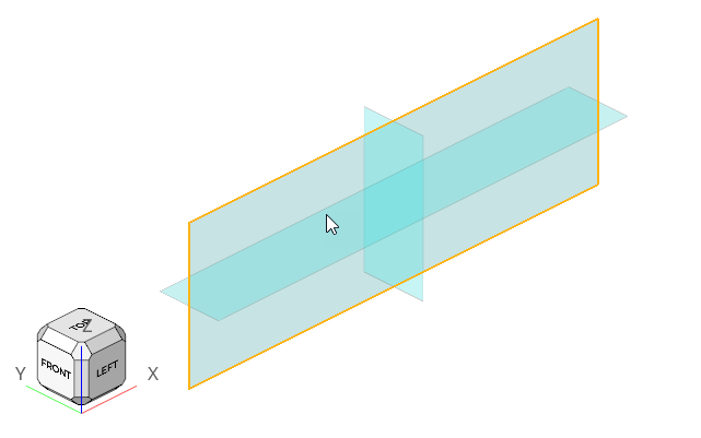

Plot Velocity and Pressure Contours on a Section Cut
