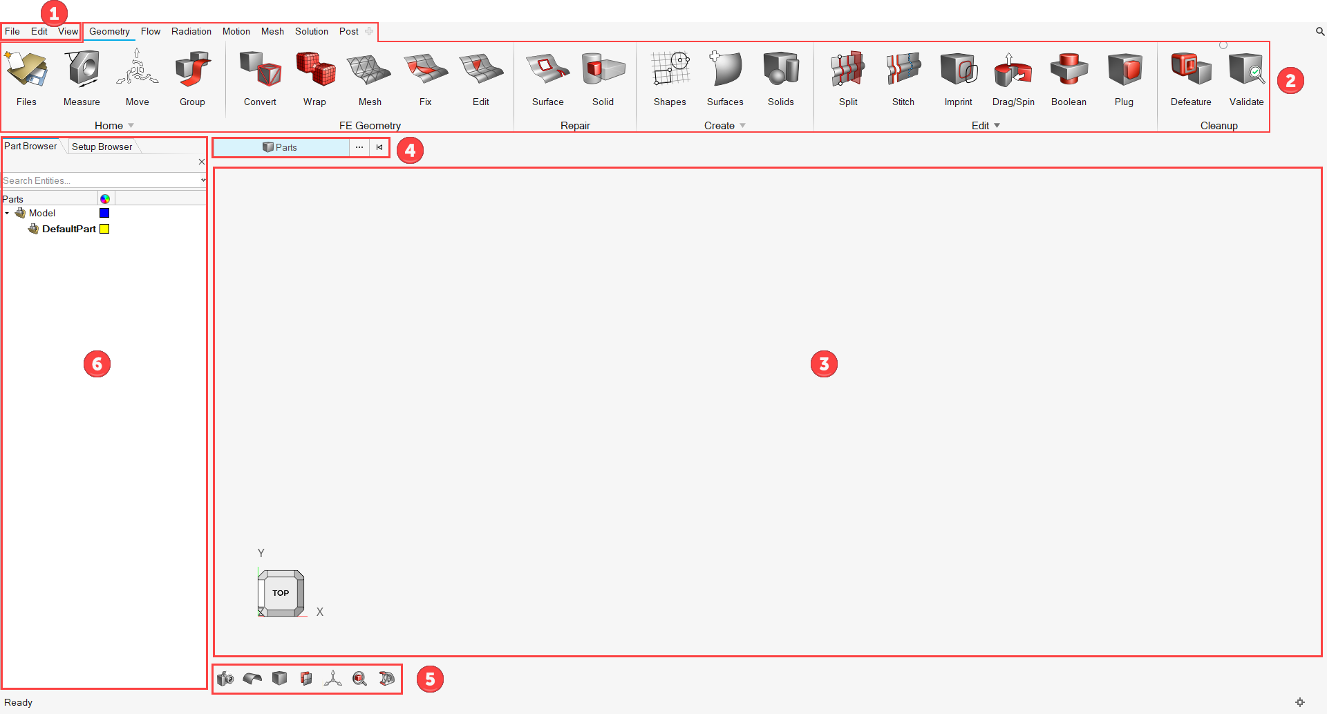

HWCFD-T: 0001 Introduction to HyperWorks CFD User Interface
- Menu bar
- Ribbons
- Modeling window
- Entity selector
- View Controls toolbar
- Browsers
- The menu bar (1) contains the drop-down menus for File input-output, Edit, and View operations.
- Ribbons (2) contain various functionalities and tools
available in HW-CFD. Navigate between various ribbons by clicking the ribbon tabs to
the right of the menu bar. After selecting a ribbon, the
corresponding tool icons are displayed on the screen. The functionalities of various
ribbons and corresponding tools are briefly explained in this section.

- The modeling window (3) is where the
model is displayed. The model display can be manipulated using the view controls
shown in the table below. Clicking on the model will highlight the entity being
selected and right-clicking on an entity will give you additional options for the
operations that can be done based on the context. Some of the functions available
using right-click are Show, Hide, Isolate, Select, Advanced select, Create groups,
and so on.

Figure 15. - The visualization of the model can be controlled using the tools available in
View Controls toolbar (5). The display of mesh, model
display mode (e.g. Topology, part, assembly, etc.), section cuts, standard views,
etc. can be controlled using these tools.
Figure 16. - The Browsers (6) show the entities and setup parameters in the model and list them in a tree structure. They can be turned on or off from the View menu. Some common functions that can be performed in all browsers are show, hide, and isolate. The Part Browser can be used to manage the model's parts, surface bodies, and solid bodies The Setup Browser can be used to create and edit instances of model setup parameters such as boundary conditions, domains, mesh controls, and so on. Neither the Part Browser nor the Setup Browser are available when working in the Post ribbon. The Post Browser can be used to control the view and edit various post-processing visualizations. The Post Browser is only available when working in the Post ribbon.
