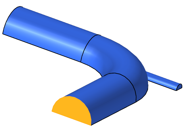

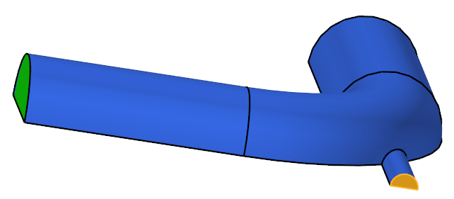

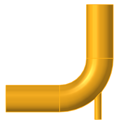

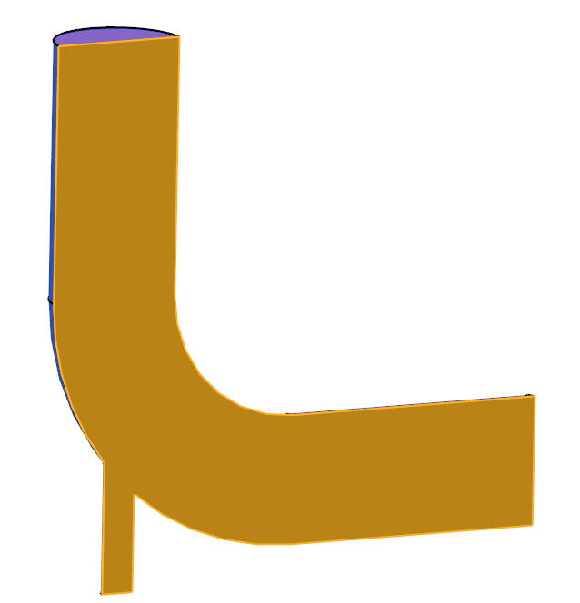

The problem to be addressed in this tutorial is shown schematically in Figure 1. This is a typical industrial example for mixing in a pipe by injecting high-velocity fluid from a small inlet into relatively low-velocity fluid in the main pipe. It consists of a 90° mixing elbow with water entering through two inlets with different velocities. The geometry is symmetric about the XY midplane of the pipe, as shown in the figure.
Figure 1. Schematic of Mixing Elbow

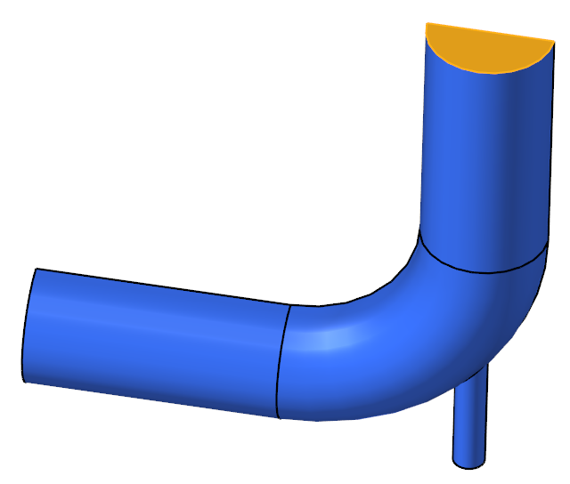

Set Boundary Conditions for the Symmetry Plane

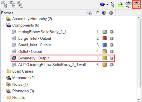

This geometry is symmetric about the XY midplane, and can therefore be modeled with half of the geometry. In order to take advantage of this, the midplane needs to be identified as a symmetry plane. The symmetry boundary condition enforces constraints such that the flow field from one side of the plane is a mirror image of that on the other side.

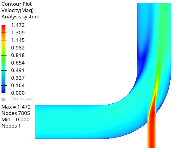

Post-Process the Results with HyperView
This part of the tutorial shows you how to work with steady state analysis data in HyperView once the solution has converged.
Open HyperView and Load the Model and Results

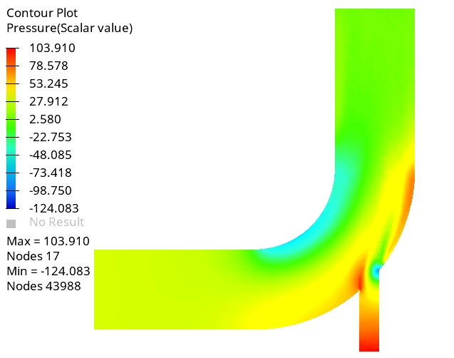

Create Contour Plots of Pressure and Velocity
Summary
In this tutorial, you worked through a basic workflow to set up a CFD model, carry out a CFD simulation, and post-process the results using HyperWorks products, namely AcuSolve, HyperWorks CFD, and HyperView. You started by importing the model in HyperWorks CFD. Then, you defined the simulation parameters and launched AcuSolve directly from within HyperWorks CFD. Upon completion of the solution by AcuSolve, you used HyperView to post-process the results and create contour plots.
