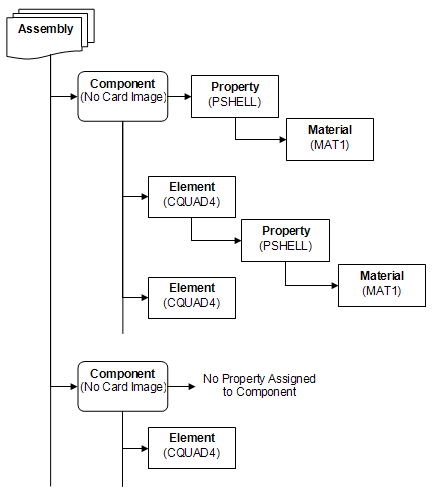

In HyperMesh 9.0, there is new core functionality for assigning properties directly to 1D, 2D, and 3D elements in addition to the existing method of assigning properties to components. Also, for solver group #1 (OptiStruct, Abaqus, Nastran) components no longer have property cards assigned to them. Instead, users create properties for all element types (1D, 2D, and 3D) the same and assign those properties to either components or elements depending on the behavior desired. The implementation for solver group #1 and solver group #2 (Radioss, ANSYS, LS-DYNA, PAM-CRASH, Permas) is given below.
Figure 1. - If property assigned to the element, that element is assigned the element property.
- If no property is assigned to the element, that element is assigned its component property.
- If no property is assigned to the element or component, that element is assigned no property.
- Materials are always assigned to properties and each element is assigned the material of its property.
Figure 2. - Property and materials are assigned to components only. Ignores any property assigned to elements.
- All elements within a component are assigned the component property and the component material.
