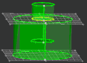

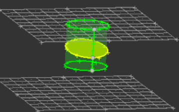

Trim with Nodes Subpanel
Use the Trim with Nodes subpanel to trim solids based on nodes that you select. The nodes must define an enclosed cross-sectional surface, but this surface need not be planar.
Multiple solids can be trimmed using the same set of nodes; each solid is trimmed according to the surface defined by those nodes, provided that this surface intersects each solid. However, HyperMesh only creates new surfaces within the solids. For example, if your nodes define a large plane that intersects two cubes, HyperMesh will only create surfaces within the cubes (and thus trim them). It will not create a single surface filling the entire area enclosed by the nodes.

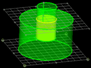

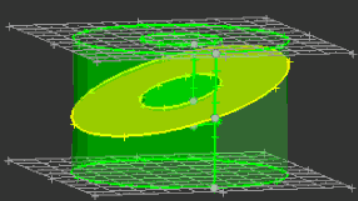

Figure 1. 4 Nodes: 2 at the Outer Edge

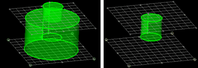

Figure 2. Single Cut

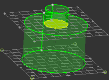

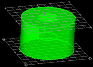

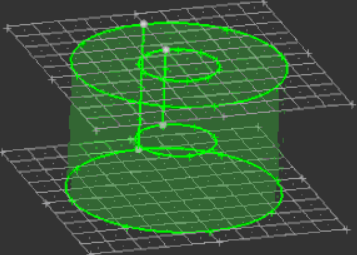

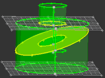

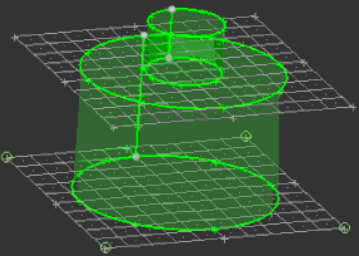

Figure 3. Solid Entity Cut along the Line Segment(s) Laid Down

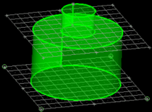

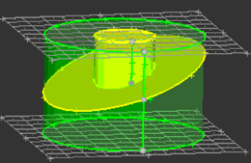

Figure 4. Solid Entity Cut along the Line Segment(s) Laid Down, Rotated Slightly

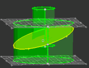

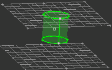

your model that define the desired cutting plane. ![]() Figure 8. Lines Selected. The top and bottom lines are selected (white). ![]() Figure 9. Solid Split. The selected solids are split along the plane bounded by the chosen lines. |

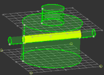

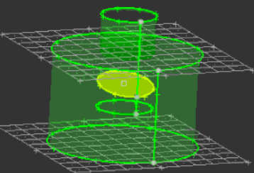

| with sweep lines: solids selector | Choose a method for
selecting solids.
Note: Regardless of the method, you are still selecting solid
entities to trim.
| with sweep lines:lines selector | Select the lines to
sweep. These lines, plus their destination, determine the shape

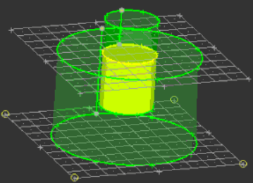

and orientation of the cut. Click trim. HyperMesh sweeps the selected line(s) along the specified vector or through the specified nodes, splitting the entity along this path (which is frequently not planar when using "end" nodes). ![]() Figure 10. Sweep All Enabled. Surfaces sweep past the nodes. |
| with sweep lines:sweep to | Choose between 1 or 2 end nodes or sweeping by a vector. |
| with sweep lines:Sweep all / Option field / N2 - N1 |

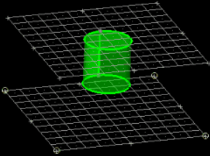

![]() Figure 11. With Sweep Lines Set to N2 - N1. The line behind the cylinder is selected, and the green and blue nodes are N1 and N2. |

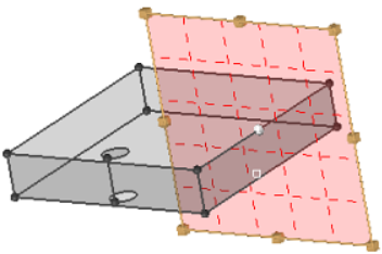

Trim with Plane/Surf Subpanel
Use the Trim with Plane/Surf subpanel to trim solid geometries using a plane or other trimming surface.
Figure 12.
This process uses the *body_splitmerge_with_plane command or *trim_solids_by_surfaces command, as appropriate.
| Option | Action |
| with plane: solids / surfs | Select the entities to
trim. If you pick surfaces, the related solids are selected.
When trim with planes is enabled, a fill cuts mode is turned on and used. Fill cuts is a special mode of surface trimming. A virtual trimmer surface is created and used to calculate and create new edges on selected surfaces. An attempt is made to insert pieces of this trimmer surface into the body when trimming of the trimmer itself by selected surfaces creates closed loops and thus cuts off those pieces. This is used to simulate solid trimming in cases when you cannot, or do not want to, create solids, but still wants to make solid-like cuts. This mode is not intended when selected surfaces are solid surfaces themselves. When attempting to insert pieces of a trimmer surface into a solid body, you may also need to manually select other surfaces in order to avoid topologically invalid results. If you do not make this selection completely correctly, the expected result will be undefined. |

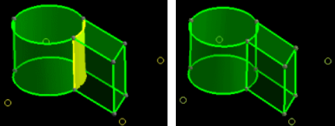

Merge Subpanel
Use the Merge subpanel to join solid entities that are currently separated by a narrow gap.

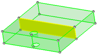

Figure 17. . The dividing surface (yellow) becomes shared (green) after merging.
You can merge solids in two ways: either select solids to merge, or select intervening surfaces to remove.

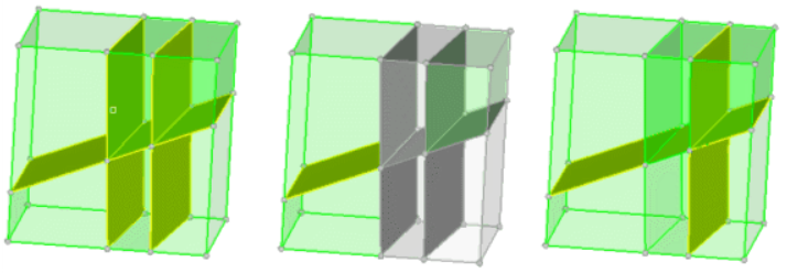

Figure 18. Attached Solids. From left to right this series shows 6 attached solids; selection of 4 of the solids; and the subsequently detached solids. Notice that the selected solids weren't detached from each other, only from the non-selected solids.
