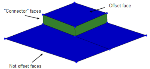

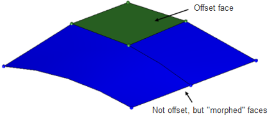

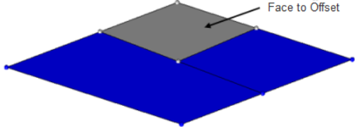

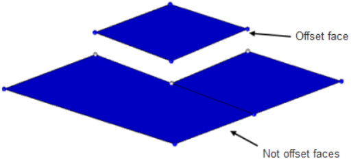

Offset Subpanel
Use the Offset subpanel to offset a group of surfaces by a given distance along the normals of those surfaces. A negative offset value can be used to offset these surfaces in the opposite direction of the surface normal. The topology of the surface edges (free, shared edges, and so on) is maintained during the offset function. Some individual surfaces will be trimmed or extended to maintain the connectivity. This function moves the selected surfaces to the new location.
If you want to save the original surfaces, the selected surfaces can be duplicated before the offset. You can review the normal direction of the surfaces by clicking vector normal or color normal. If the offset direction is incorrect, the reverse normal function can be used to reverse the normal of a selected surface. If there are elements associated to the offset surfaces, the element will not move along with surfaces. The association between the elements and their surfaces is broken.
Figure 15. No Offset Performed on Surface
Figure 16. Disjointed Surface
Figure 17. Offset using the Continuous Option
Figure 18. Offset using the Continuous Option, with Separator Lines Specified. Separator lines are specified at the edges of the offset surface.
| Option | Action |
| disjoint offset / continuous offset |
| update eccentricity | Specify a value to be stored internally, and can be used later by the Midsurface Thickness Map utility. It will not affect the movement of the offset surface; instead, the surface's associated thickness and offset values will remain in its original location, but be given values relative to its new location. Later, these values can be used in the midsurface thickness utility to map its thickness and offset to FE elements. |
| remove degenerations | Remove degenerations, which are surfaces that become collapsed or unnecessary as a result of the offset. |
| autocomplete separators | Automatically select all segments of a closed loop of lines when you select a single line within the segment. |
| surfs selector | Select the surface to offset. |
| separator lines: lines selector | Select where the offset surface should remain attached; new surfaces will be generated to keep the surface continuous. |
| offset = | Specify a positive or
negative offset value. If you are uncertain where the positive
normal direction lies, use the vector normal or color normal
buttons to display it, and reverse normal if
necessary/desired. Note: The edges of a surface
are offset in the normal direction, so curved surfaces may
expand or shrink when offset in either the positive or
negative direction. Surface dimensions are not
preserved.

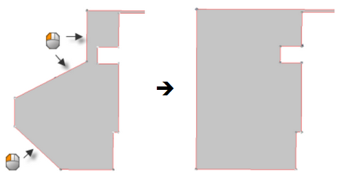

Extend Subpanel
Use the Extend subpanel to extend or retract the edges of selected surfaces to meet other selected surfaces, or to close gaps between surfaces or holes within a selected surface.
| Option | Action |
| max extension / extend over edges |
| to surfaces | Extend the extending
surfaces as far as necessary to meet these ones. Note: Available
when extend over edges is selected.
| by distance / by thickness multiplier |
| by filling gaps / by distance / to surfaces |
| surfs: to extend selector | Select surfaces to
extend. If you selected any shared (green) or non-manifold (yellow) edges as lines: to extend over, then this selector enables you to specify the corresponding surfaces so that HyperMesh knows which surface to use to determine the plane of extension for the shared/non-manifold edge. Additionally, you may need to use this selector to specify any "target" surfaces, particularly if you use the cross extension option. Edges will only extend toward surfaces that are also selected, even if those additional surfaces have no extending edges. These recipient/target surfaces will also be trimmed, if the trim result surfaces checkbox is enabled. |
| cross extension / surfs: to target selector |
| lines: to extend over | Select edges to extend. Surfaces will be extended across these lines. If you select a free edge, this also selects and highlights the corresponding surface. |
| surfs: to extend | Select surfaces to extend. |
| surfs: to target / cross extension |
| trim result surfaces | When this checkbox is
enabled and all of the selected surfaces are extended or
shortened to have their edges meet, then the selected surfaces
will be trimmed or stitched regardless of which components they
belong to. When this checkbox is cleared, the result varies
further.
When this checkbox is enabled and the selected surfaces extend through their target surfaces, or even merely to the interior without actually touching any of the target surface edges, the surfaces will be both trimmed and stitched at the intersection regardless of whether or not they belong to the same component. However, when this checkbox is cleared, the surfaces are not trimmed or stitched, since they do not meet at any edges. |

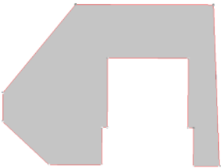

Shrink Subpanel

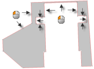

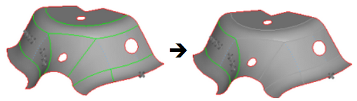

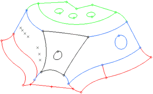

Use the Shrink subpanel to shrink the surface by drawing all of its edges (including internal edges from holes, and so on) back away from their starting location.
Figure 20. Surface Before Shrinking. The black surface has been selected.
Figure 21. Surface After Shrinking. The edges of the selected surface pull inward, away from the initial edge locations.
| Option | Action |
| surfs selector | Select surfaces to shrink. |
| offset | Specify the distance
that each edge of the surface moves further into the surface.
Note: Holes in the surface will get larger, not
smaller, as their edges move further into the surface
instead of out into the empty space bounded by the
hole.
