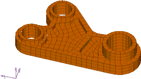

![]() Figure 1. Solid Model Created by Dragging Automeshed Plate Elements |

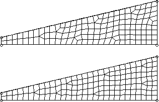

| flow: align |
Produce a more orthogonal quad-dominant mesh.
![]() Figure 12. No Flow Alignment ![]() Figure 13. Flow Alignment. Flow alignment is used, producing straighter rows of elements. |

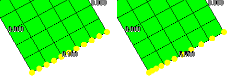

| adjust: edge | Change the biasing factor for an edge. When this selector
is enabled:
![]() Figure 16. Increase Biasing Factor |

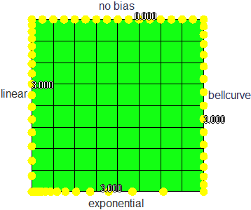

| bias style | Select the biasing style to apply to edges when using the set
edge and set all to options.![]() Figure 17. Example: Bias Style |
