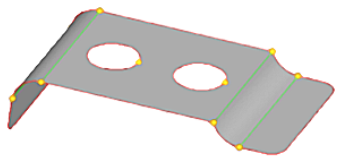

Pinholes Subpanel
Use the Pinholes subpanel to identify and close pinholes (circular internal loops lying on a relatively planar surface). You can search for pinholes as well as elongated non-circular slots based on diameter. Pinholes with a diameter equal to or less than the value you specify will be located and can be removed/closed. Similarly, slots whose lengths are less than the diameter you specify will also be found and can be closed.
- It lies on a surface that is almost planar.
- The ratio between the area and the perimeter of the shape is above a reasonable threshold, defined thusly: For a given length of the loop, the circle shape yields maximal area. HyperMesh checks that the area of the loop is at least half of the expected area of a perfect circle with the same characteristic diameter.
Figure 1. Pinholes on Top of Part

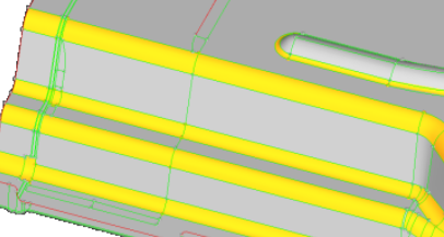

Surf Fillets Subpanel
Figure 2. Surface Fillets. The curved yellow surfaces are fillets.
When removing surface fillets, the algorithm starts after you select the surfaces and click remove. Selected surfaces are considered to be fillet surfaces. The work of the removal algorithm does not depend on the result of the work by the fillet detection algorithm (which is invoked by clicking find fillets). You can manually select all of the surfaces that you believe to be fillets and want removed. Once such a decision has been made and the surfaces are selected, the removal algorithm does not interfere with this decision in any way other than simply failing to defillet wrongfully (in its opinion) selected surfaces.

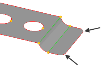

Edge Fillets Subpanel
Use the Edge Fillets subpanel to identify and remove edge fillets. Similar to surface fillets, edge fillets create smooth curves at the intersection of relatively perpendicular free edges. You can identify them based on the radius of the fillet arc, and then remove them.
An edge fillet is a part of the trimming loop of a surface that can be roughly equivalenced to a circular arc under the conditions that are specified in the min and max radius and angle fields.
Figure 3. Edge Fillets. The arrows point to edge fillets.
