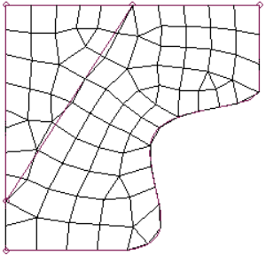

Smooth Panel
Use the Smooth panel to improve element quality in a surface-based mesh or a mesh of solid elements using one or more algorithms that adjust node positions to moderate sharp variations in size or quality in adjacent elements.
Location: 2D and 3D pages
The Plates subpanel adjusts the positions of the free nodes of the selected plate or shell elements to smooth out variations in element quality and size.

The Solids subpanel adjusts the positions of the free nodes of the selected solid elements to smooth out variations in element quality and size. A node is free if it is not associated to a surface, all of the elements to which it belongs are selected, and the entire volume around it is occupied by selected elements.
Plates Subpanel
Use the Plates subpanel to optimize mesh consisting of 2D shell elements.
For any elements that are not associated to surfaces, HyperMesh infers an approximation to the shape of the surface that most likely produced these elements. A message appears in the status bar indicating the largest change in node location encountered during the final iteration.
