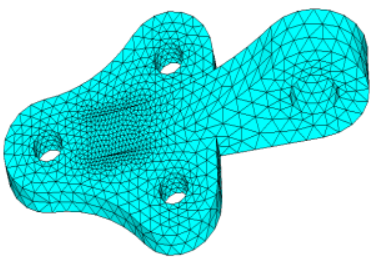

- swappable
- Swapp the edges of the free boundary faces. The mesh nodes stay unchanged.
- remeshable
- Remesh the free boundary faces.
![]() Figure 1. Fixed |
![]() Figure 2. Remeshable |

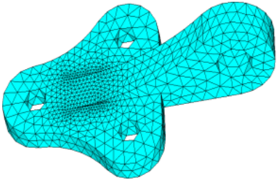

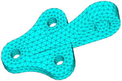

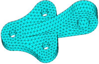

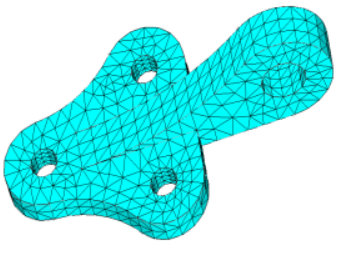

Volume Tetra Subpanel
Use the Volume Tetra subpanel to generate a shell mesh and fill the enclosed volume with solid elements.
![]() Figure 3. Without Proximity |
![]() Figure 4. With Proximity |
![]() Figure 5. With Proximity |
![]() Figure 6. With Proximity and Curvature |

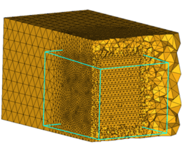

Refinement Box Subpanel
Use the Refinement Box subpanel to define a specific box-shaped volume within an existing tetramesh in which to generate finer mesh.
You can specify some elements to be fixed, and others to be floatable. A fixed tria-quad element is one that must be exactly represented as a face of a tetra/penta-pyramid/hexa element in the final mesh. A floatable element is one whose nodes locations are used, but the exact connectivity of those nodes can be modified if it produces a better mesh. Unless you need a special mesh type, for example surface layers of pentas/hexas, you should select as fixed only those elements that must match a pre-existing mesh, leaving the rest floatable. If the bounding surface contains quad elements, and if these quad elements are defined as fixed elements, then a first layer of elements is generated on the boundary, and pyramid elements are generated from the quad faces. However, when quad elements are defined as float elements, they are split into two trias, and the tetra meshing proceeds normally.
You can also specify various growth options in order to control the tradeoff between the number of tetras generated and their quality. Higher, more aggressive growth rates produce fewer elements, but they may be of poorer quality.

| Refinement size |
Specify the target element size for mesh inside of the
refinement box.
Note: The actual mesh size will vary in order to
maintain mesh connectivity at the edges of the box.
![]() Figure 9. Boundary Region Selected as With BL (flat) and Remesh ![]() Figure 10. Remeshed Surface. The region included in the refinement box has been remeshed with the elements size assigned to the refinement box. |
