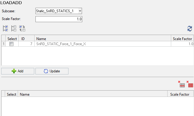

In this step you can combine static loads. The panel for LoadAdd Creation is shown below.
Figure 1. - Select Subcase - to select the required subcase from a drop down list.
- Scale Factor - to provide a scaling factor for the static load combination
- Load collector list table -
- All the static loads created in the previous tasks will be listed in the first table.
- Allows you to select constraint(s) to combine.
- You can use the selection options in the table.
- Select All
- Unselect All
- Reverse Selection
- Add - to create and add the LOADADD cards in the second table.
- Update -to update a previously created LOADADD card
- Delete Selected and Delete All options to delete the LOADADD cards from the second table.
