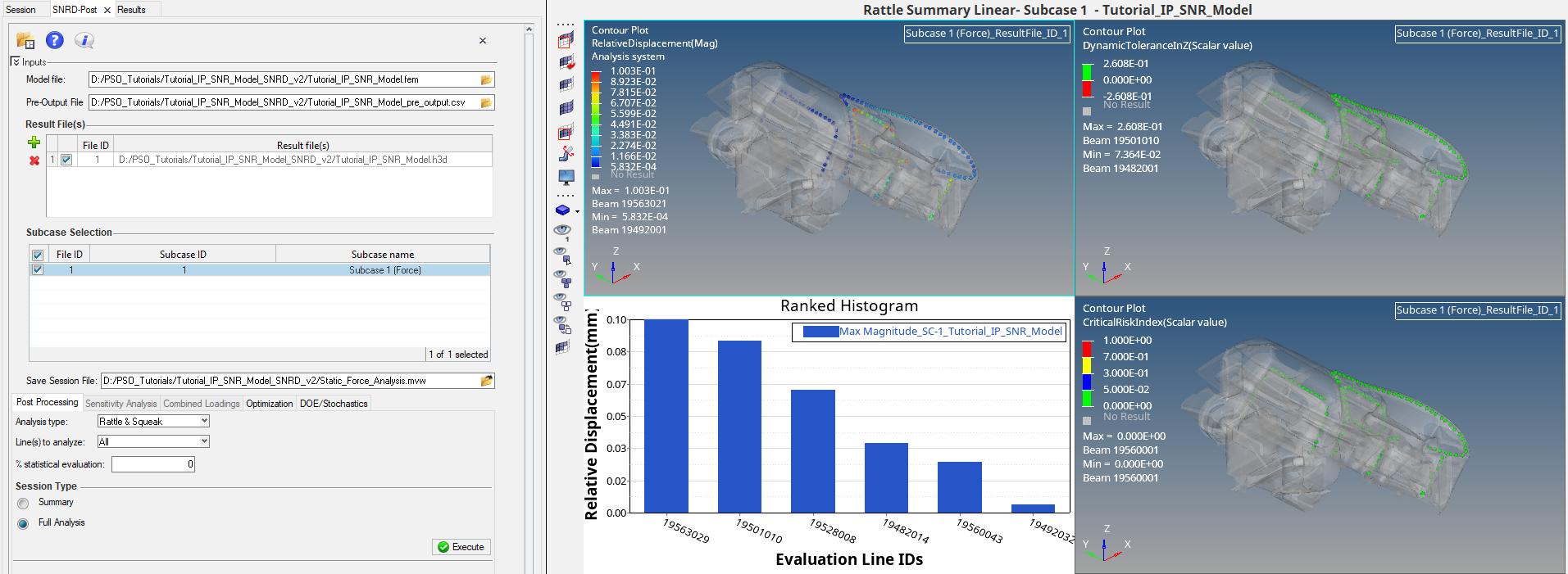

- SnRD Post Processing TutorialNote: For Quality Feel (Static) Analysis, please use the H3D file generated after solving the FEM
- Once Post Processing is done,you can review the plots
and results to view the squeak and rattle issues. Form the analysis, it can be noticed that the static load applied is not causing any squeak or rattle issue in the model. The relative displacements for all the interfaces are well below the gap and gap-tolerance values.
Figure 1. - You can refer to Optimization Setup to learn more about the optimization solver deck setup to further optimize the design and analyse the reduced SnR issues.
