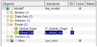

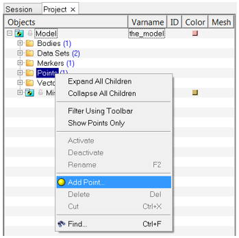

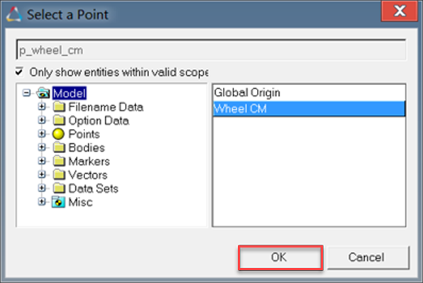

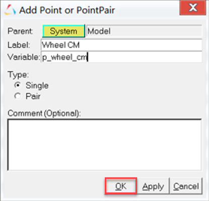

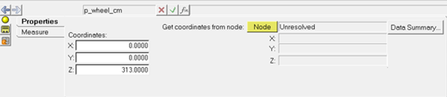

Add a Point to the Model
In this step, you will add a point to the model.

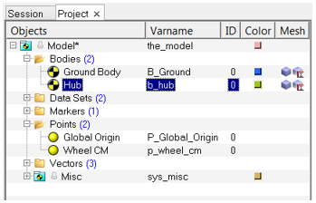

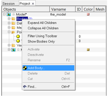

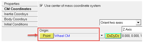

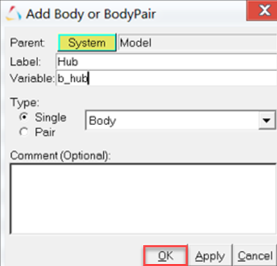

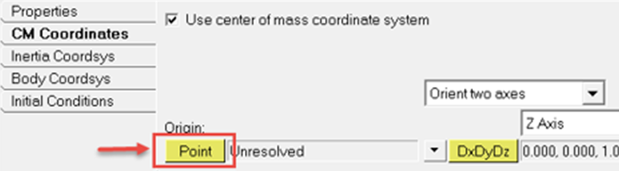

Add a Hub Body to the Model
In this step, you will add a body to the model and define the center of the Hub body.

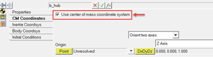

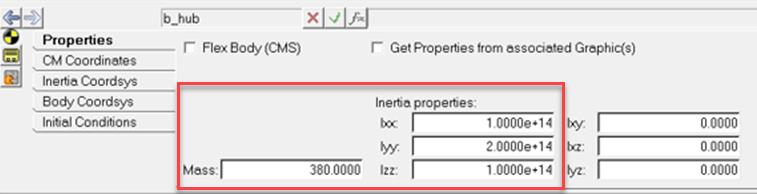

Update the Mass and Inertia Properties of the Hub Body
In this step, you will update the mass and inertia properties of the Hub body.

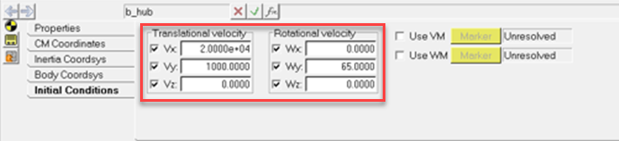

Set the Initial Conditions for the Hub Body
In this step, you will set the initial conditions for the Hub body.

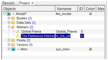

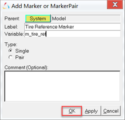

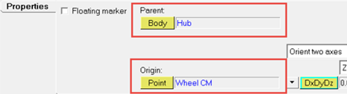

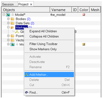

Add a Marker to the Model
In this step, you will add a marker to the model.

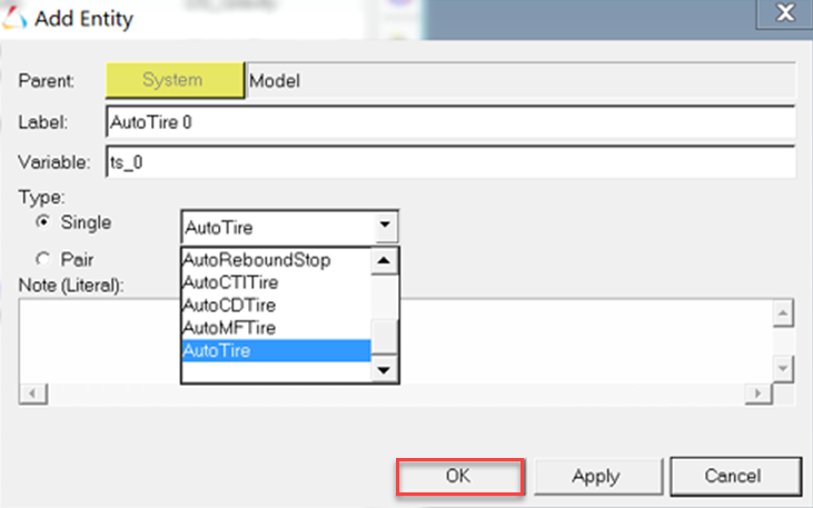

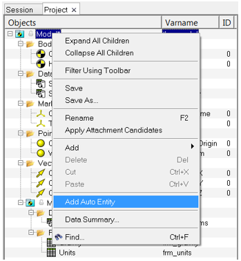

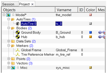

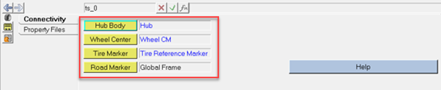

Add an AutoTire Entity to the Model
In this step, you will add and autotire entity to the model.

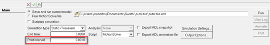

Run the Model in MotionSolve
In this step, you will run the model in MotionSolve.

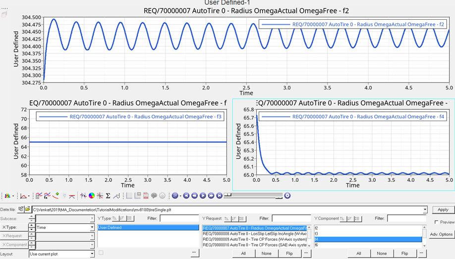

Figure 29.
- REQ/70000005 Auto Tire0 – Radius OmegaActual OmegaFree
- f2 - Radius – Rolling radius of the tire.
- f3 - OmegaActual – Angular velocity of the tire.
- f4 - OmegaFree – Angular velocity at which the tire will be having a zero slip ratio.

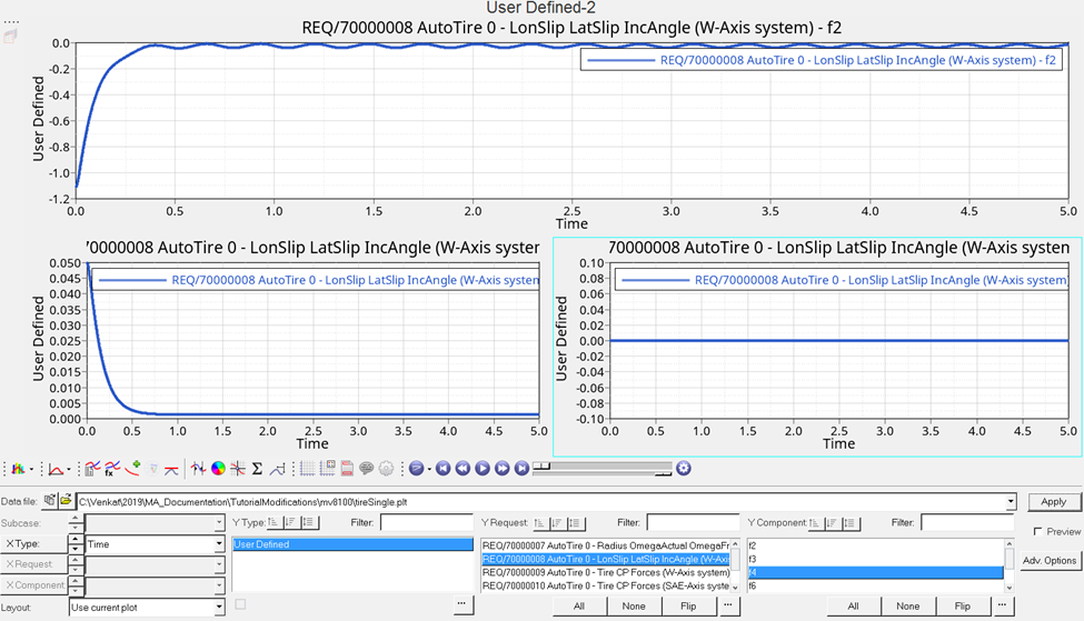

Figure 30. - REQ/70000006 Auto Tire0 – lonSlip latSlip IncAngle
- The following outputs are available in both ISO and SAE co-ordinate systems.
The one shown in plots are in ISO.
- f2 - LonSlip - Slip Ratio or Longitudinal slip in percentage. In this case the tire is rolling freely therefore the slip ratio is approximately 0.
- f3 - LatSlip - Lateral slip starts from 0.05 as lateral slip is the ratio of Vy and Vx. In our case Vy/Vx = 1000/20000 = 0.05
- f4 - IncAngle – Inclination Angle of the tire from XZ plane.

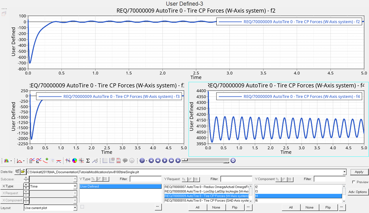

Figure 31. - REQ/70000007 Auto Tire0 – Tire CP Forces (W-Axis system)
- The Tire contact patch forces are available in both W and SAE axis system.
The one shown in plots are in W-axis System.
Figure 32.

REQ/70000007 Auto Tire0 – Radius OmegaActual OmegaFree

REQ/70000008 Auto Tire0 – lonSlip latSlip IncAngle
The following outputs are available in both ISO and SAE co-ordinate systems. The one shown in plots are in ISO.
Figure 34.
REQ/70000009 Auto Tire0 – Tire CP Forces (W-Axis system)
The Tire contact patch forces are available in both W and SAE axis system. The one shown in plots are in W-axis System.
Figure 35.
