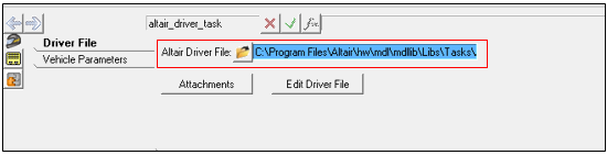

Source the file in the Altair Driver File
browser.
Figure 9.
Note: The Edit driver file button can be used to edit the file.

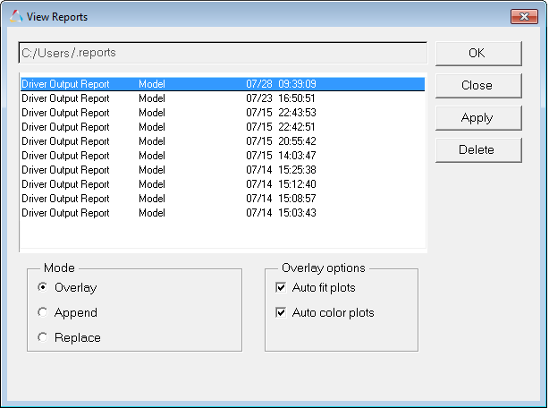

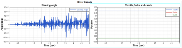

After the simulation is over and the solver creates the h3d and plt files, from
the menu bar, click Analysis > View Reports.
Figure 10.
Select the recent run in the View Reports dialog and click
OK.
Figure 11.
The noise in the steering is numerical error of negligible magnitude – 0 for
all practical purposes. Throttle is constant at 0.5 (driver throttle, brake and
clutch outputs are normalized so, 50%) and brake is constant at 0.
Figure 12.

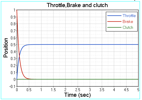

Next we will try slightly different initial conditions. We will start the
throttle at 0 and brake at 100%. Click the Edit Driver
File button to open up the file editor.
Change the INITIAL_VALUE attribute in the THROTTLE_STANDARD block in the ADF,
from 0.5 to 0.
Now, we see that throttle and brake start from respective initial values and
step up to the controller outputs. The time taken to step up is roughly
(5x1/SMOOTHING_FREQUENCY).
Figure 13.

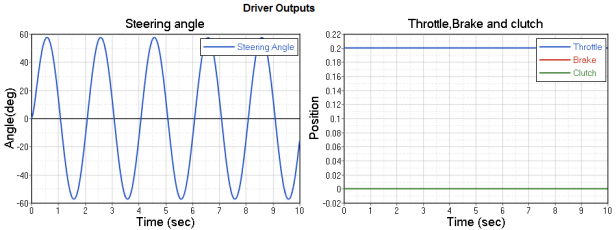

Model an Open Loop Sinusoidal Steering Event
In this step, you will model a simple event with constant 20% throttle, constant 0%
throttle and sinusoidal steering input with amplitude of 60 degrees (∏/3 radians) and
frequency of 0.5 Hz.
Open any text editor and copy and paste the following text into it.
Important: All blank lines must be removed prior to saving the
file.
$-----------------------------------------------------------------ALTAIR_HEADER[ALTAIR_HEADER]
FILE_TYPE = 'ADF'
FILE_VERSION = 1.0
FILE_FORMAT = 'ASCII'
$--------------------------------------------------------------------------UNITS[UNITS](BASE)
{length force angle mass time}
'meter' 'newton' 'radians' 'kg' 'sec'
$--------------------------------------------------------------------VEHICLE_IC[VEHICLE_INITIAL_CONDITIONS]
VX0 = -20.0
VY0 = 0.0
VZ0 = 0.0
$--------------------------------------------------------------STEERING_STANDARD[STEER_STANDARD]
MAX_VALUE = 3.141593
MIN_VALUE = -3.141593
SMOOTHING_FREQUENCY = 10.0
INITIAL_VALUE = 0.0
$--------------------------------------------------------------THROTTLE_STANDARD[THROTTLE_STANDARD]
MAX_VALUE = 1.0
MIN_VALUE = 0.00
INITIAL_VALUE = 0.2
$---------------------------------------------------------------BRAKING_STANDARD[BRAKE_STANDARD]
MAX_VALUE = 1.0
MIN_VALUE = 0.0
INITIAL_VALUE = 0.0
$-----------------------------------------------------------------MANEUVERS_LIST[MANEUVERS_LIST]
{ name simulation_time h_max print_interval}
'MANEUVER_1' 10.0 0.01 0.01
$---------------------------------------------------------------------MANEUVER_1[MANEUVER_1]
$This block provides the ties controllers to each driver output
TASK = 'STANDARD'
(CONTROLLERS)
{DRIVER_SIGNAL PRIMARY_CONTROLLER ADDITIONAL_CONTROLLER}
STEER OL_STEER NONE
THROTTLE OL_THROTTLE NONE
BRAKE OL_BRAKE NONE
$---------------------------------------------------------OL_STEER.$SIGNAL_CHANNEL tells the driver which solver variable in Signal Generator to over-ride$with the EXPRESSION value. The EXPRESSION should be consistent with MOTIONSOLVE.[OL_STEER]
TAG = 'OPENLOOP'
TYPE = 'EXPRESSION'
SIGNAL_CHANNEL = 0EXPRESSION = 'DTOR(60)*SIN(2*PI*0.5*TIME)'$---------------------------------------------------------OL_THROTTLE [OL_THROTTLE]
TAG = 'OPENLOOP'
TYPE = 'CONSTANT'
VALUE = 0.2
$---------------------------------------------------------OL_BRAKE[OL_BRAKE]
TAG = 'OPENLOOP'
TYPE = 'CONSTANT'
VALUE = 0.0
Run the simulation and study the results.

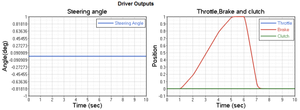

Model an Open Loop Curve Driven Braking Event
In this step, you will model a simple event with braking signal as a
curve.
Figure 15.
Open text editor and copy and paste the following text into it.
file!

$---------------------------------------------------------------------MANEUVER_1[MANEUVER_1]$This block provides the ties controllers to each driver output
TASK = 'STANDARD'
(CONTROLLERS)
STEER OL_STEER NONE
BRAKE OL_BRAKE NONE
TAG = 'OPENLOOP'
TYPE = 'CONSTANT'
VALUE = 0.0
$---------------------------------------------------------OL_THROTTLE[OL_THROTTLE]
TAG = 'OPENLOOP'
TYPE = 'CONSTANT'
VALUE = 0.0
TAG = 'OPENLOOP'

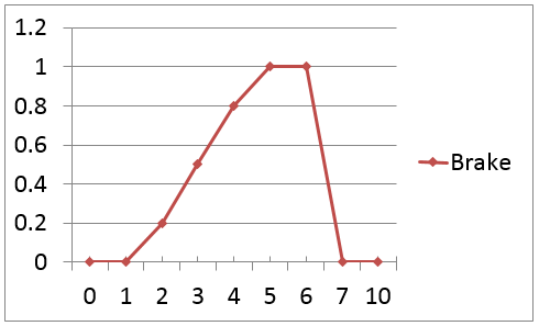

TYPE = 'CURVE'
BLOCK = 'BRAKE_CRV'
$---------------------------------------------------------CURVE_DATA[BRAKE_CRV]
INDEPENDENT_VARIABLE = 'TIME'
DEPENDENT_VARIABLE = 'BRAKE_SIGNAL'
INTERPOLATION = 'LINEAR'
{TIME BRAKE_SIGNAL}
0 0
1 0
2 0.2
3 0.5
4 0.8
5 1.0
6 1.0
7 0
10 0
