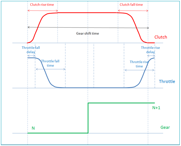

In this tutorial, you will learn how to interface gear clutch control for vehicles with manual transmission.
- Gear clutch controller
- The Engine speed based shift controller upshifts whenever engine speed goes above the upshift RPM, and it downshifts when the engine speed goes below the downshift RPM. The Gear shift controller also controls the throttle and clutch signal as shown in the figure below.
