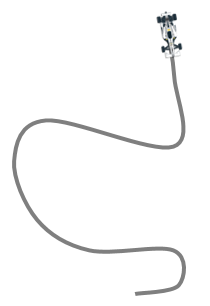

Figure 2. - Predefined path
- Path is one of the predefined paths visualization (Constant Radius, Single lane change, Double lane change, and Slalom).
$Example block for constant radius path [PATH] TYPE = 'CONSTANT_RADIUS' RADIUS = 30 INITIAL_STRAIGHT = 45 TURN = 'LEFT‘ -

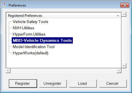

Ensure the MBD-Vehicle Dynamics Tools preference file loaded is for all of the
MotionView functionality of the Advanced Driver
to work properly.

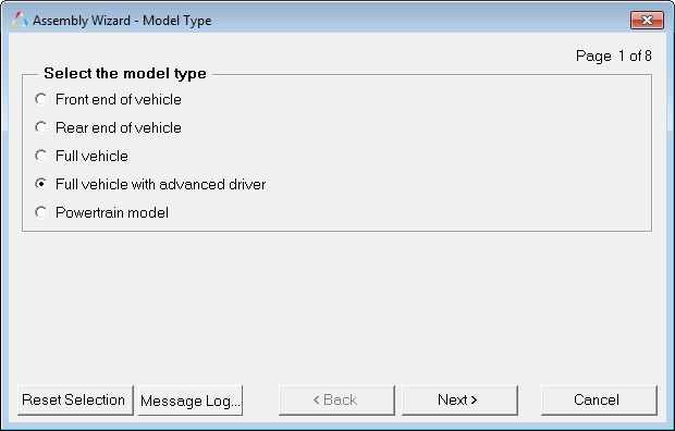

From the menu bar, select Model > Assembly Wizard.
In Script an Open Loop Acceleration Event, a linear torque map powertrain will be used to avoid the complexity of adding controllers for gear and clutch.
Figure 6. -
Select the Full vehicle with advanced driver
option.
This takes care of all the dependencies of the advanced driver.
Figure 7. - Click Next.

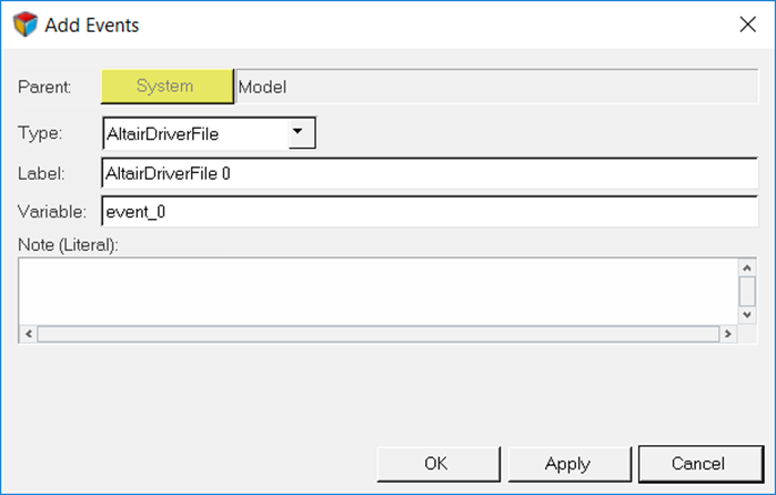

From the menu bar, select Analysis > Task Wizard.
Figure 8. -
Select AltairDriverFile from the Type drop-down
menu.
Figure 9.Tip:Selecting
(Altair Driver
icon) will open up the Altair Driver panel.

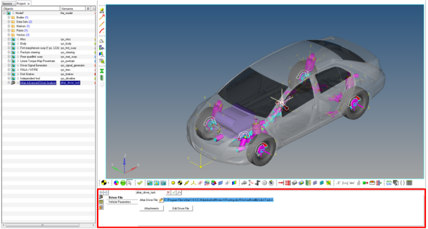

This automatically resolves all of the vehicle attachments for the
Altair Driver.
Figure 10. Selecting the AltairDriverFile 0 will open up the driver event panel. Selecting the Event Editor button will open the Altair Driver File dialog.
