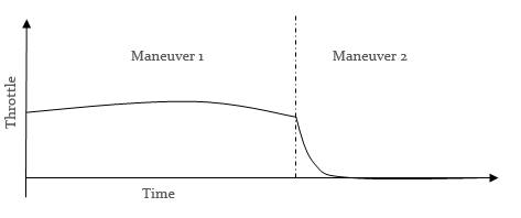

Example:
- Maneuver 1
- Constant radius cornering, constant radius path with constant velocity - until roll angle reaches its maximum and stabilizes.
- Maneuver 2
- Step down the throttle while following the same path.
In this event, Maneuver 1 would typically consist of closed loop steering and throttle controllers. In Maneuver 2, the steering controller still remains the same, however the throttle controller is open loop, type expression – ‘STEP(TIME – end time of maneuver 1 , 0, throttle value at the end of maneuver 1, 0.5, 0)’.

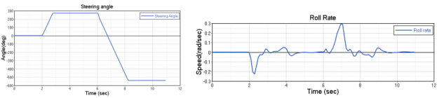

Write an Altair Driver File (ADF) Driving Event
Fish Hook Event
We will model this event in three maneuvers.
