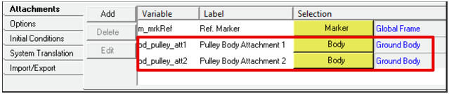

By default, two pulleys are available. To add or delete a pulley, use the
right-click option on a row item indicating the pulley number.

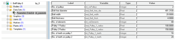

| DataSet |
A dataset where all editable values are stored. After the
creation of the belt-pulley system, you can change the free
diameter and width of the belt through this dataset. |
