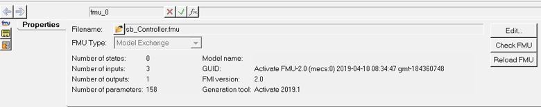

Figure 1. FMU panel - Properties tab
| Property | Type | Description |
| Filename | File | FMU file name with path. |
| FMU Type | String | Type of FMU.
If an FMU contains both types, this option is available for selection. |
| Number of states | Integer | Number of states within the FMU. |
| Number of inputs | Integer | Number of input channels the FMU is seeking. |
| Number of outputs | Integer | Number of output channels from the FMU. |
| Number of parameters | Integer | Number of parameters in the FMU. |

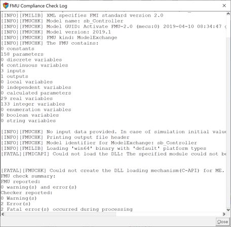

| Check FMU | Runs the FMU compliance checker to provide more information and verify the validity of the FMU. See Comments. | |
| Reload FMU | The FMU is reloaded. |

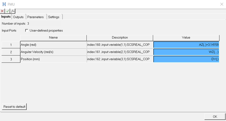

Click on Edit FMU... to view and edit Input, Output, Parameters and Settings.
Figure 2. FMU dialog
This dialog has the following tabs:

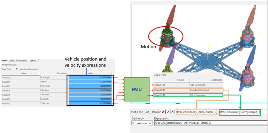

Input
The input tab lists all the input channels in the input array with their name and description.
Provide a solver expression under the Value column to each of the channels as input to the FMU. The value of this solver expression is computed by MotionSolve during simulation and communicated to the FMU at every time-step of the simulation.
Output
This tab lists all the output channels in the output array from the FMU with their names and descriptions.

Connect an FMU to the Model
Comments
An FMU could be of the type Model Exchange (ME) or Co-simulation (CS) or both. An ME FMU contains the necessary states and variables that could be solved by the calling solver. A CS FMU can contain its own solver or calls another solver. In this case, two solvers co-simulate (one calling solver and other solving the FMU) to solve the entire model. An FMU may contain both modes ME and CS. In this case, the Type attribute in the FMU panel will be editable and you can select the mode in which the FMU is solved.
Figure 4. FMU Compliance Check Log from Check FMU
