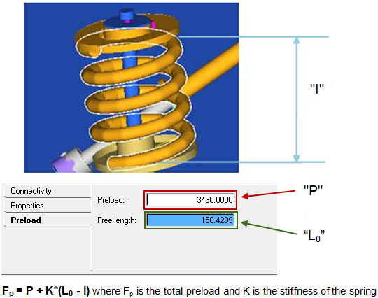

- Preload is the initial force or torque in the spring in the modeled
position. The total preload can be specified by using either the Preload
value, the Free Length value, or a combination of the two.
Figure 1. - The total preload Fp is applied as the summation of Preload P and
the force due to change in length K* (Lo –l); where K is the stiffness, Lo
is the free length, and l is the modeled length of the spring (refer to the
figure above).
- For example, if the two end points of the defined spring (modeled length of spring) is 100 mm and the free-length is specified as 110, that represents the spring in a pre-deflected state by 10mm and the effective preload is 10*K; where K is the stiffness of the spring.
- If the Preload value is specified in addition, this force is also added to the total preload.
- In another example, if the two end points of the defined spring (modeled length of spring) is 100 mm and the free-length is 0.0, that means in the current state the spring is in an extended state by 100mm and the preload to that effect (-100*K) is applied.
- MotionView creates a coil spring damper with a default value free-length as the distance between two end points.
