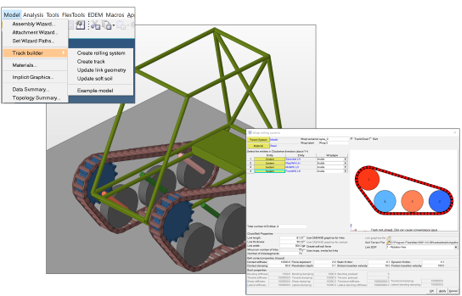

Track Builder
Refer to the Track Model topic in the MotionSolve User Guide for additional details.

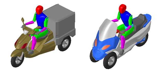

New Leaning Three-Wheel Example Models
Figure 2. 1+2 and 2+1 Three-Wheel Leaning Vehicles

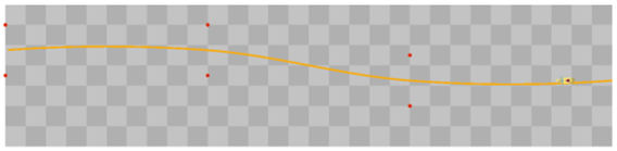

Figure 3. - Road Graphics
- In addition, when you select to run on a flat road the event editor
offers you the option to create road and path graphics. A road settings
dialog give you control over the size and colors of the graphics.
Figure 4. Single Lane Change Event with Road and Path Graphics - Driver PID Gains
