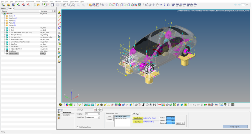

Wheel Posts
Figure 1. A Post is added for each AutoTire
Coupling

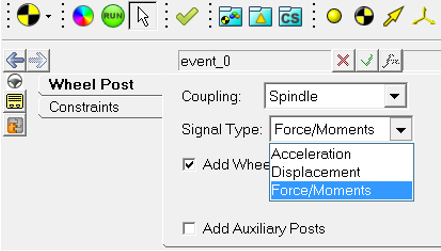

Signal Type
You can input Displacement, Force/Moment and Acceleration signals to wheel posts:- Displacement signals
- Force/MomentNote: If the ‘Add Wheel Reaction Forces’ option is checked, the reaction forces are calculated at the wheels, after the static simulation and added to the Z-direction force signal provided by the user. The force signal is applied to the Wheel Post and can be seen in the n-Post Signal Manager.
- Acceleration: Acceleration is first converted to displacement, following which the displacement is applied.
Figure 4. Signal Types

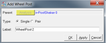

Other Panel Options
- If the tires in the vehicle are not ‘AutoTires’, you will have to manually add a Wheel
Post by using the ‘Add’ button in the panel. Using the ‘Delete’ button will delete the
chosen post.
Figure 5. Manually add a Wheel Post, in the absence of AutoTires - Each Wheel Post has three attachments Body, Point and Joint, similar to the Wheel Posts
added to the AutoTires.Note:
- Body and Point attachments are necessary for the inplane joint mentioned above under the Coupling section.
- The Joint attachment is used for locking the wheels.
