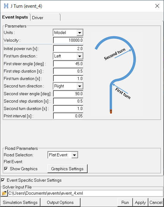

- Event Parmeters
Parameter Description Units Velocity unit selection (Model, m/s, km/h, mph). Velocity Initial vehicle velocity. Initial power run The time at the beginning of the event used to verify the vehicle reached the steady state. First turn direction Defines the steer direction used in the first turn. First steer angle Angle in degrees of the initial steer input. A positive number turns the vehicle right and a negative number turns the vehicle left. First lean angle* The demand lean angle for the initial turn. First step duration Time required to input the First steer angle (Step function is used to input the angle to the steering wheel). First turn duration Time duration for which the steering is held fixed at the First steer angle. Second turn direction Defines the direction used in the second turn. Second steer angle Steering angle in degrees of the second steer input. Second lean angle* The demand lean angle for the second turn. Second step duration The time required to input the Second steer angle (Step function is used to input the angle to the steering wheel). Second turn duration Time duration for which steering is held fixed at the Second steer angle. Print interval Time interval of data output to the plot file (.plt) and graphics file (.h3d). *Applicable only for Two-wheeler events.
- Road Parameters
- Use the road parameters to select the road that the vehicle drives on for the event.
You can choose to use a flat road, a road data file you select from the event editor,
or the road data files selected by tires. The table below describes the parameters in
detail.
Parameter Description Road Selection This option menu determines the road selected for the event. There are three choices: - Flat Road - Use a flat, smooth road for the event. No road file is needed. Use the road settings to control the road graphics and road mu.
- From Event - Select a road file from the event road file field. All tires in the model use this road file when running the event.
- From Tires - For each tire in the model, use the road file selected for that tire in the AutoTire panel. This allows you to use different road files for different tires.
Road Selection = Flat Road When the road Selection is Flat Road, then the event is run on automatically generated flat road data file.
Mu (Friction Scale) Enter a value greater than or equal to zero that scales the tire-road surface friction. Note the tire-road surface friction is defined in the tire properties. So, if you enter a 0.5 here and the tire-road friction coefficient is 0.8, the effective coefficient of friction is 0.5*0.8 = 0.4. Show Graphics Check this box to create graphics for the flat road. Note the graphics are created when you click the Apply or Run button on the event editor. Graphic Settings Push this button to display a dialog that controls the flat road graphics, to learn more about the controls see the Road Settings section below. Road Selection = From Event Road File When the Road Selection option is From Event, use the road file field to select the road file for the event. Road Selection = From AutoTires
When the Road Selection is From AutoTires, then each tire runs on the road property file specified for it in the AutoTire panel. This allows the use of different road files for different tires, for example, one road for the right tires and another for the left tires to provide different vertical disturbance.
