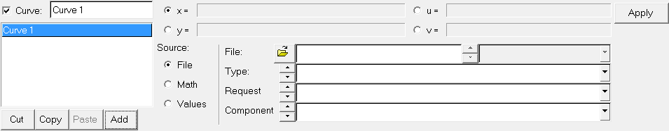

File as a Data Source

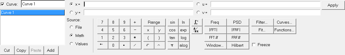

Math as a Data Source
If Math is selected as the source, the curve calculator is displayed, allowing you to define the vector mathematically.
- Curve Calculator
- Curves can be defined mathematically using the curve calculator.
- Range
- Defining a range is a quick way of specifying a spread of values for a vector. Click Range to display the Range dialog.
- Calculus Functions
- Integrals and derivatives are displayed
as:
integral(,) derivative(,)Independent and dependent vectors must be supplied for both functions.
See Math Reference for a detailed description of each function and its purpose.

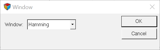

- Signal Processing
- Fast and discrete Fourier transforms, as well as windowing, power spectral density, and frequency response functions can be included in expressions.

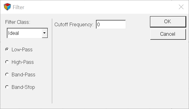

- Filter
- Curves may be passed through two classes of filters, ideal or SAE. Click Filters... to display the Filter dialog box.

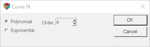

- Fit
- Polynomial and exponential functions can be fit to curves. Click Fit... to display the Curve Fit dialog box.
- Math Functions
- The Functions... button displays a dialog box containing all available
math functions. External functions or Templex functions can be registered in the program using
*RegisterExternalFunction() or
*RegisterTemplexFunction() in the preference
file.
Any of the functions can be inserted into the current expression by selecting the function name from the list or by typing the name directly into the equation.
See the List of Standard Functions topic in the Math Reference help for more information.

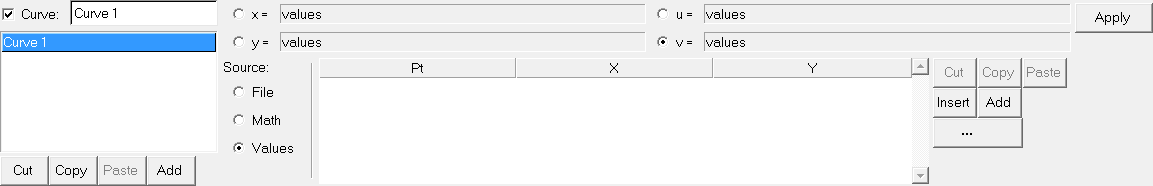

Values as a Data Source
