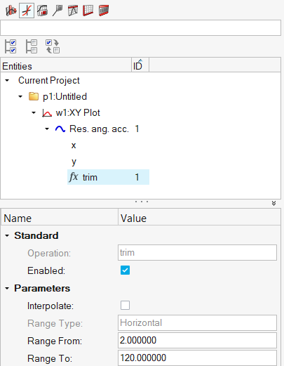

Click Proceed,
, to
complete the action.
Note: From the Plot Browser, select the edited curve(s) to view the action performed and its related data.
