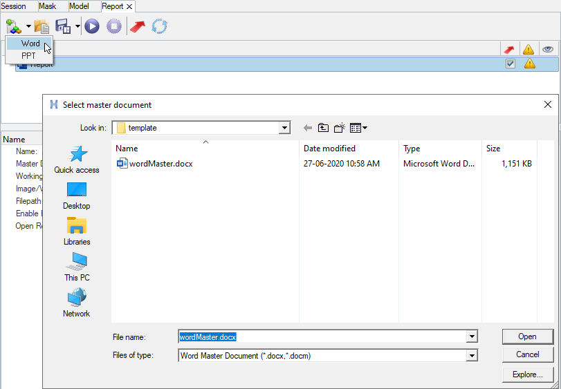

- From the menu bar, select File > Publish > Report.
- Select the Document Master file using New > Word.
Select the required Document master file. from the Select master
document dialog,

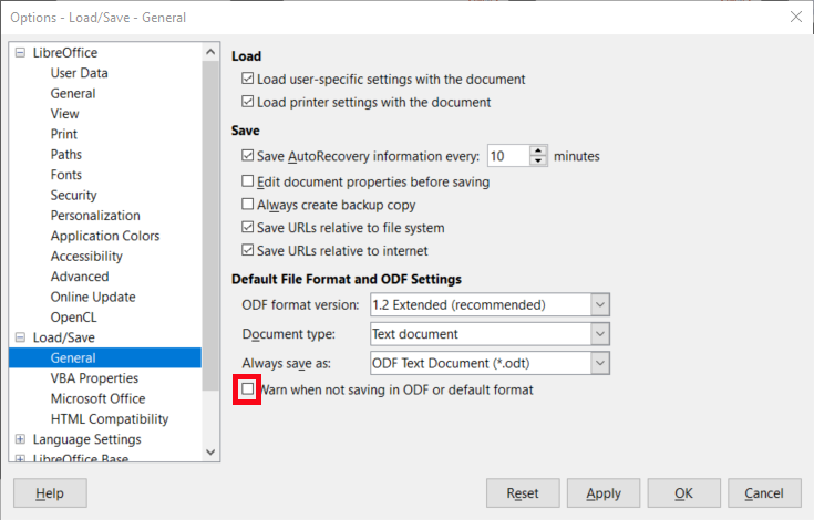

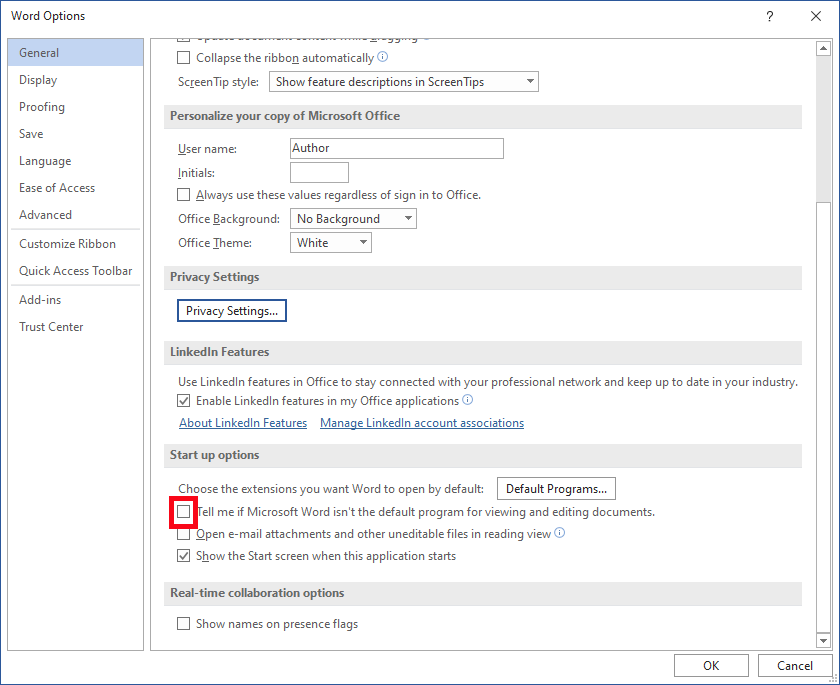

Important: When exporting a report, verify the following options for these word processing software types:- For MS Office-
Figure 2. - For LibreOffice-
- For MS Office-
