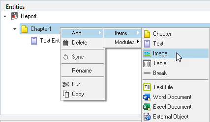

Add an image to the report.
- Right-click at the Report or Chapter level and select .
s

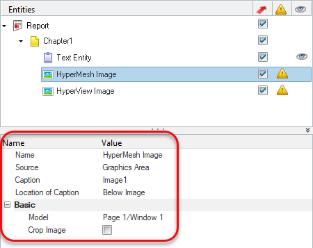

Figure 1. - Below are the properties associated with the Image entity.Note: Image properties are HyperWorks client dependent. They are listed below.
- HyperMesh properties
Figure 2.- Name: You can change the name property of the image item.
- Source: Select the image source.
Figure 3.- Graphics Area: Capture an image from the graphics area.
- Capture State: Enables you to capture an image using a dynamic rectangle. If selected, the Capture Dynamic Rectangle option is activated. Check this option and capture the image by drawing a rectangle anywhere in the screen.
- Caption: Provide a caption for the captured image. This caption is visible in the exported report.
- Location of Caption: Select the caption location from the
list. These are standard locations as present in Microsoft
Word. Image captions locations can be:
- Below Image, or
- Above Image
Figure 4.
Basic
- Model: Select the required page or window from the HyperWorks session.

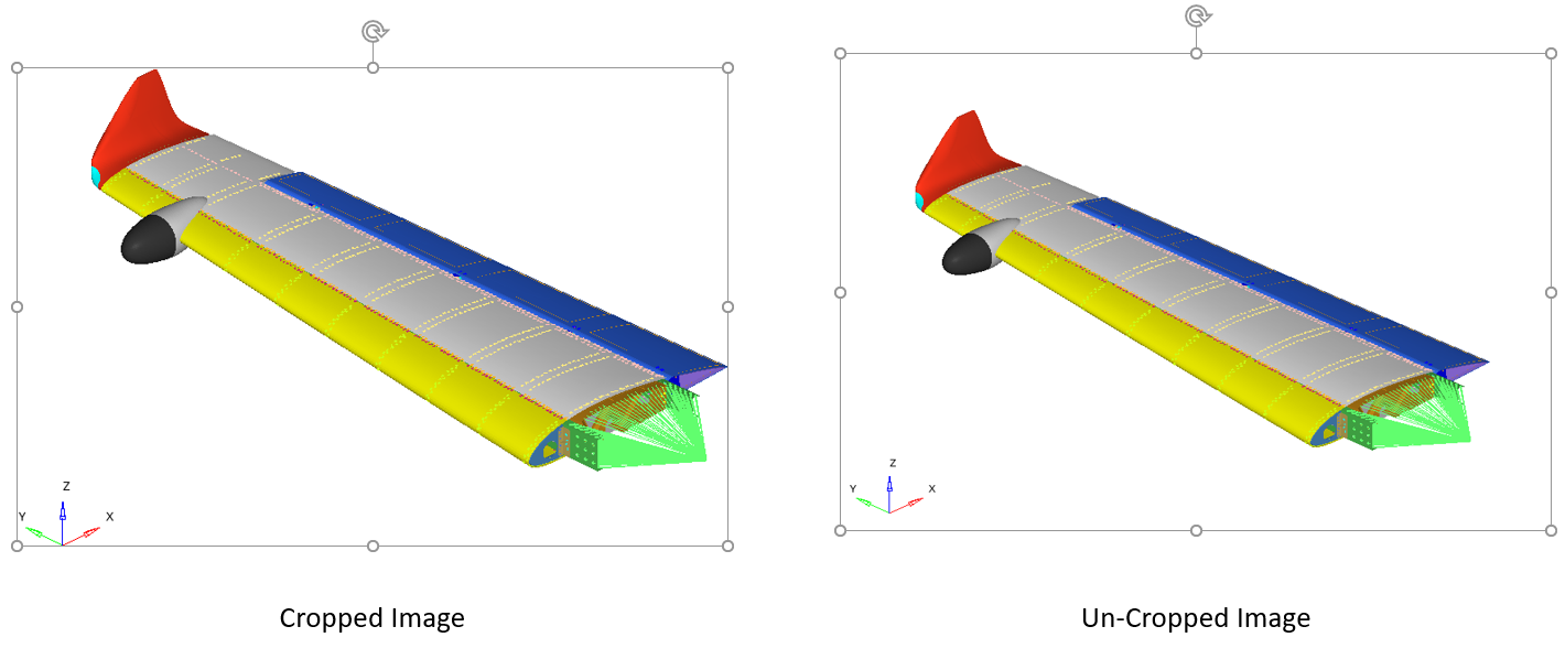

- Crop Image: Checkbox option to crop an image. This option
discards empty/white space in the graphics area and exports
only the model area. Below is an illustration of the crop
image option.

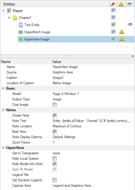

- HyperView properties
Figure 6.The first four properties are the same as the HyperMesh client.
Basic
Figure 7.- Model: Select the required page or window from the HyperWorks session.
- Output Type: Choose between various output formats for the
exported image. The available output types are:
Figure 8.- Image: A .png (static) image is exported.
- Animated GIF: A standard animation file is exported. The GIF option is supported only for Presentation reports.
- H3D: A HyperView results
file with the animation is exported.Note: H3D preview is not available on LibreOffice 5.0.

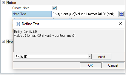

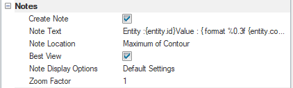

Figure 9.- Create Note: Checkbox option to create notes in the images. This activates other note creation options.
- Note Text: Enter the desired query options in the
Define Text dialog.
Figure 10.Note:- You can manually enter the expressions or query statements. The same syntax from the Description section of the Note creation panel in HyperView can be followed.
- You can also configure note expressions using
the array of default note query options. Select a
note type and click Insert.
This query is added to the note and will be
exported to an image in the report. The list is
shown below.
Figure 11.

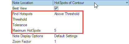

- HotSpots of Contour: Notes are created at hotspots
of an entity. There are a few options that are
required to capture the hotspot values. They are
listed below.
Figure 13.- Find Hotspots: Find hotspots for values above or below threshold values.
- Threshold: Numerical value to define the threshold.
- Tolerance: Numerical value to define the tolerance between contour values of two adjacent elements.
- Maximum Hotspots: Number for hotspots for note creation.Note:

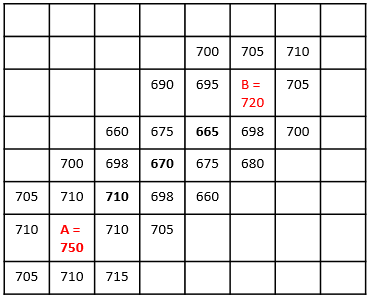

- The hotspot detection algorithm first finds the element with the highest contour value (center element). It then finds the adjacent elements and their contour values. If these contour values are lower than the center element, then the elements adjacent to these elements are found and correspondingly the contour values. This is repeated until an element is found that has a contour value higher than its center element by the Tolerance specified by you. This element is considered as the new hotspot.
- For example, if you have set the tolerance as
50, element A has the highest contour values
(750). ARD finds adjacent elements and their
contour values (710, 670, 665) until it finds the
element B (710) which has the highest value. B
shows 720 in the image.
Figure 14.

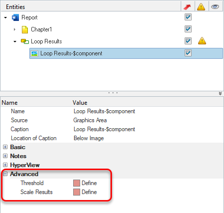

Advanced Options
When an image entity is added under a Loop Results module, additional results processing properties are activated. They are listed below.
Figure 18.To utilize the advanced options, you have to select components and loadcases for the Loop Results module first.

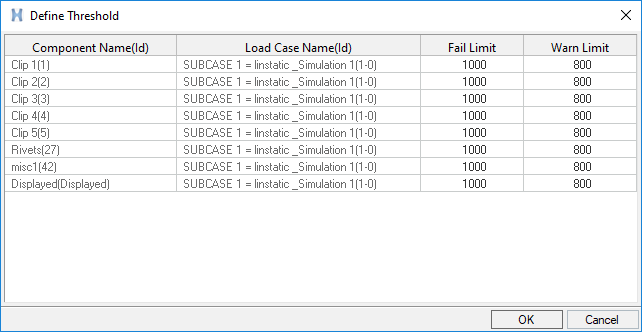

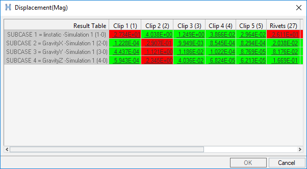

- Threshold: Define the Fail and Warn limits for the results
looping.
Fail and Warn limits are suggested automatically based on the contour values of the applied results. You can edit them as well.
Figure 19.Once executed, a results table with the color codes is added to the report.- Red for Fail
- Yellow for Warn
- Green for Safe

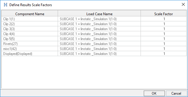

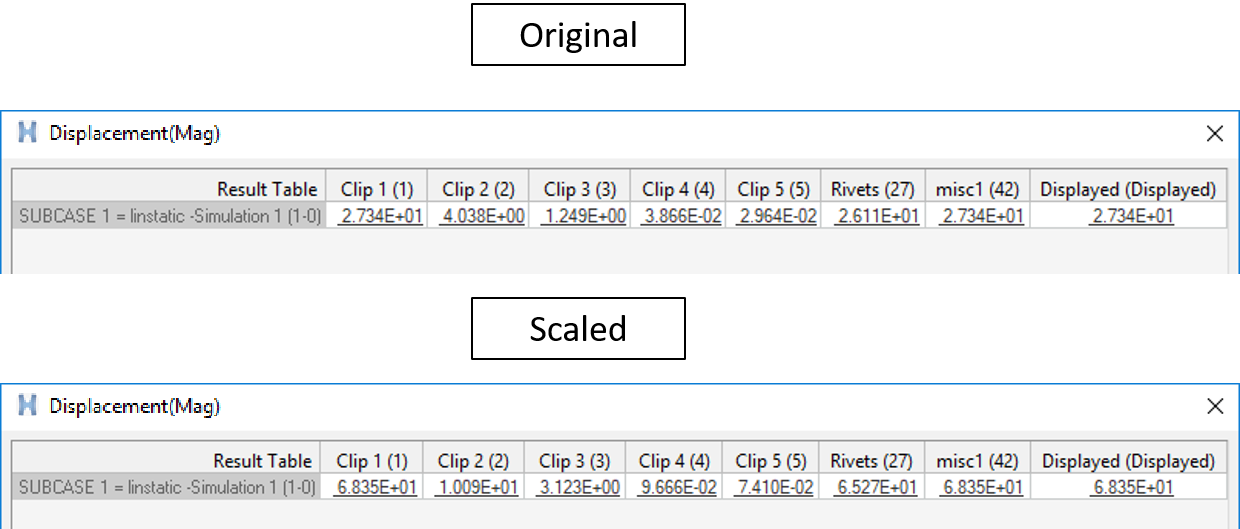

Figure 20. - Scale: Scale contour results for looping.
Figure 21.Scale factor is set to one by default; you can edit them as well.
Once executed, a result table with the scaled results with the scale factor is added to the report.
