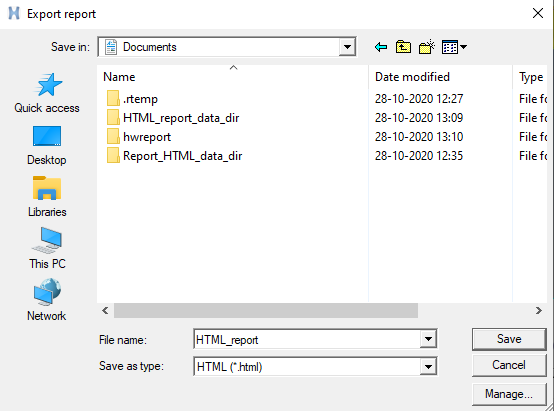

Check the boxes under the Export
Export report.
After the execution, export the report to your chosen location.
Select Save as type: HTML(*.html) and click
Save.
Figure 1. -
