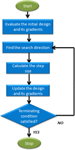

- The number of evaluations in each iteration is automatically set and varies due to the finite difference calculations used in the sensitivity calculation. The number of evaluations in each iteration is dependent of the number of variables and the Sensitivity setting. The evaluations required for the finite difference are executed in parallel. The evaluations required for the line search are executed sequentially.
Figure 1. Sequential Quadratic Programming Process Phases
