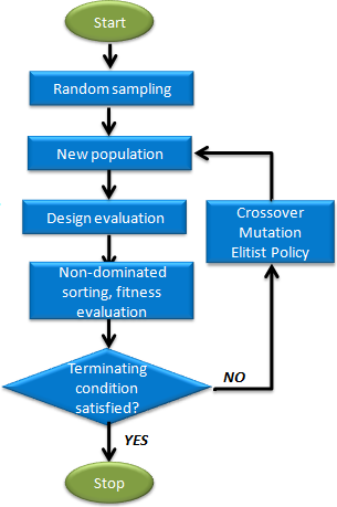

- Multi - Objective Genetic Algorithm uses a crowding distance metric to create a homogeneous distribution of the non-dominated points on the Pareto front.
- Multi - Objective Genetic Algorithm terminates if one of the conditions below are
met:
- The convergence criteria is satisfied. This occurs when the minimum number of allowable iterations (Minimum Iterations) are run, feasible designs are found (Constraint Violation Tol. (%)), and the non-dominated designs did not change in the last iteration.
- The maximum number of allowable iterations (Maximum Iterations) is reached.
- An analysis fails and the Terminate optimization option is the default (On Failed Evaluation).
- Supports input variable constraints.
- Although the number of evaluations per iteration is a combination of multiple settings, it is primarily affected by the Population Size setting. All evaluations within an iteration may be executed in parallel. If parallel computing is required, it is recommended to use the Meta-Model or No Hybrid method.
Figure 1. Multi - Objective Genetic Algorithm Process Phases
