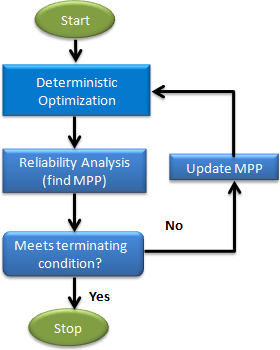

- Sequential Optimization and Reliability Assessment terminates if one of the conditions below are
met:
- One of the two convergence criterias are met.
- The absolute objective change is less than a convergence tolerance value (Termination Criteria) and there is no constraint violation (Constraint Violation Tol. (%)).
- The relative objective change is less than a convergence tolerance value (Termination Criteria) and there is no constraint violation (Constraint Violation Tol. (%)) in the last design.
- The maximum number of allowable iterations (Maximum Iterations) is reached.
- The reliability analysis is carried out by searching for the most probable point (MPP). Issues such as non-uniqueness of the MPP and highly non-linear output response functions can reduce the accuracy of the reliability calculation.
- The number of evaluations in each iteration is automatically set and varies due to the finite difference calculations used in the sensitivity calculation. The number of evaluations in each iteration is dependent of the number of variables. The evaluations required for the finite difference are executed in parallel. The evaluations required for the line search are executed sequentially.
Figure 1. Sequential Optimization and Reliability Assessment Process Phases
