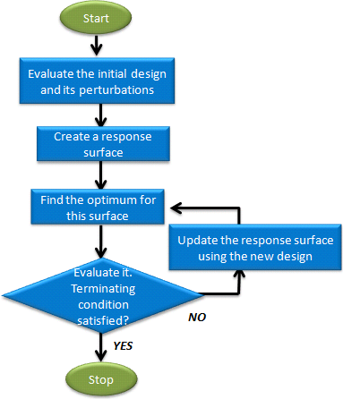

Adaptive Response Surface Method (ARSM)
Internally builds response surfaces and adaptively updates them as new evaluations are available.
The first response surface the Adaptive Response Surface Method builds is a linear regression polynomial, then it finds the optimum on this surface and validates it with the exact simulation. If the output response values from the response surface and the exact simulation are not close; the Adaptive Response Surface Method updates the surface with the new evaluation and finds the optimum in this updated surface. This loops is repeated until one of the convergence criteria is met.

Figure 1. Adaptive Response Surface Method Process Phases
