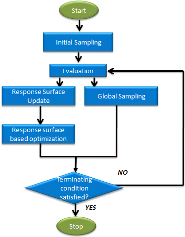

- The size of the first iteration is controlled by the Initial Sampling Points setting. The number of evaluations in subsequent iterations is controlled by the Points per Iteration setting. All designs generated within one iteration can be executed in parallel.
Figure 1. Global Response Search Method Process Phases
