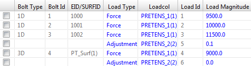

Pretension Manager Dialog
| Column | Description | Related OptiStruct Card(s) |
| Bolt Type | Displays the type of bolt the load is applied to. Can be 1D or 3D. | PRETENS |
| Bolt Id | Displays the identification number of the Bolt Pretension section the load is applied to. | PRETENS |
| EID/SURFID | Displays the Element (1D) or Surface (3D) identification number where the Bolt Pretension section is located. | PTFORCE, PTADJST |
| Load Type | Allows you to review and edit the type of pretension load, by
selecting one of the following options from the pull-down
menu:
Use the Control key to select and edit this field in multiple rows at once. Click OK or Apply to update the load types in the model. Click Cancel to exit the Pretension Manager without saving any changes. |
PTFORCE, PTADJST |
Allows you to review and edit the Load Collector where the
pretension load is organized in HyperMesh, by
menu:
PTFORCE, PTADJST | |
| Load Id | Displays the HyperMesh internal identification number of the individual loads. | |

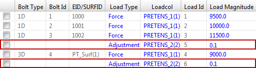

| Load Magnitude | Allows you to review and edit the pretension load
magnitude. Use the Control key to select and edit this field in multiple rows at once. Enter a new value and press Enter to apply the changes to all of the selected rows. Click OK or Apply to update the load types in the model. Click Cancel to exit the Pretension Manager without saving any changes. |
PTFORCE, PTADJST |
| Orientation | (Optional) Allows you to review and edit the determination
type of the normal direction of the bolt pretension section, by
menu:
| Output DOF ID | (Optional) Allows you to review and edit the SPOINT that
contains the pretension deformation and load, by selecting one
of the following options from the pull-down menu:
Use the Control key to select and edit this field in multiple rows at once. The Output DOF ID value will be updated in the model immediately after editing selection. |
PRETENS |

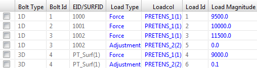

| View | Controls the Pretension Manager table's
view organization mode. There are two options available from the
pull-down menu:
